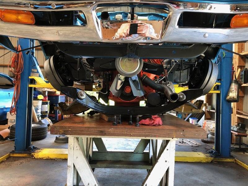

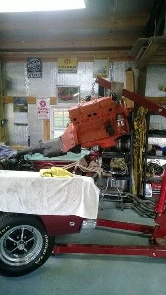

It ain't easy, trust me, especially with the transmission on too.
As this pic shows, the assembly is a lot longer than the opening in the car, so from here, severe angles must be used.
Guy underneath the car, guy above steering, another guy manning the lift usually...

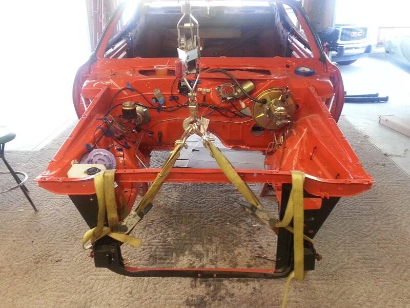

For years I did it from above because I didn't have the equipment or smarts to do it from underneath.
One thing I do like about A bodies is that you don't have to remove the hood like on B and E bodies.
Then I come across this lifting bar that bolts to the frame and that changed things for me.
Now I have a lift to make it even easier.
Not everyone has a lifting bar or a lift so ya gotta do what ya gotta do.

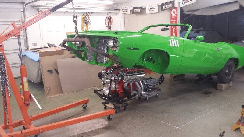

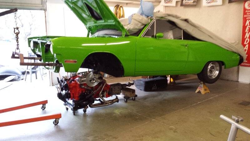

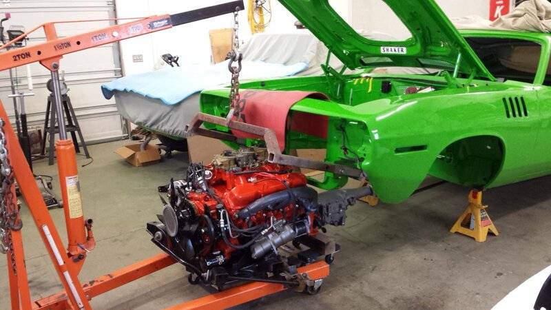

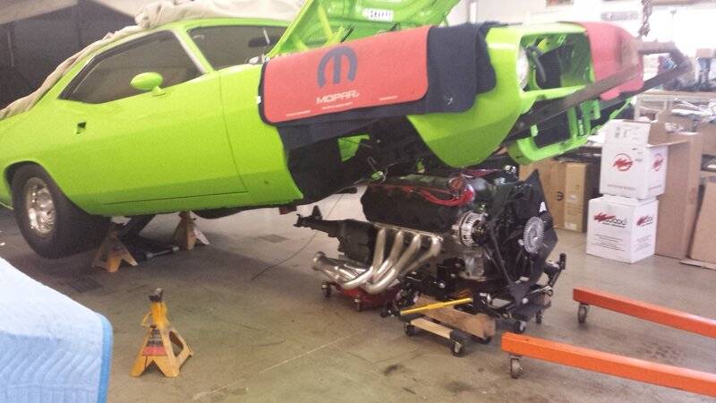

Buy the way a big ol fat Indy Hemi does not fit from underneath like a factory Hemi does. About 3" wider. That was a bit of work.

These were all ground up builds so from underneath just made since. Believe me I've stabbed them from the top many a time. Still do if a motor R&R is all I'm doing.

I totally agree doing it from the bottom. Disconnect the torsion bars, upper control arms, steering, K member and transmission mount and drop away! Much more controlled and easier too, since you can connect headers, starters, and accessories before the engine install.
Highly recommend it if you haven't done it before. I will never go back to doing it from above.
