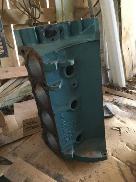

Your block may be plugged! There's a bolt on each side of the motor down near the bottom, pull those plugs and take a screwdriver or something and dig that crap out. Then report back. Good Luck
Do you happen to have a pict of them? Kinda fighting around headers to locate them.
About 1/3 back from timing cover & 2-3” up from oil pan rail.
Been a long time, I think between 1st&2nd freeze plugs; but closer to pan rail. Pretty close to rear of mtr mount.
Found a pict online. That it between the two plugs?
