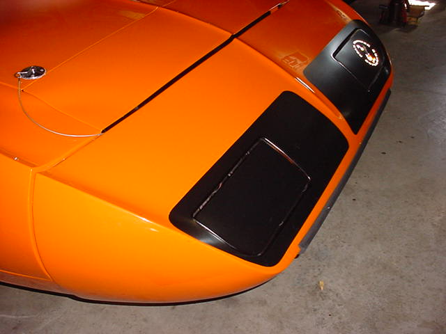

Oh yeah, placing big pointy noses on daytona and superbird clones tends to cause overheating. I'll probably have to buy a couple of those $1200 aluminum radiator packages.

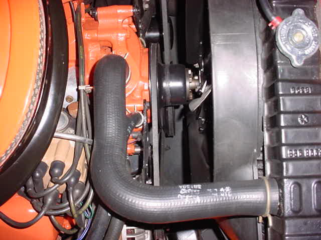

Not really and not a clone.Original radiator,fan and clutch.180* thermostat.Stays there all the time.Just make sure you have the shield that goes from the bottom of the core support to the K member.

The biggest problem that I see with many cooling systems that have been changed over the years from the factory set up is that many are trying to move the fan too close to the radiator. What will work the best is with the fan basically 1/2 in and 1/2 out of the rear edge of the fan shroud. If you have the fan too close to the radiator the fan is basically "windmilling" the air around inside of the shroud. With the fan set back it creates a suction in the shroud pulling the air through the radiator rather than just milling the air around inside the shroud.
Exactly right!
