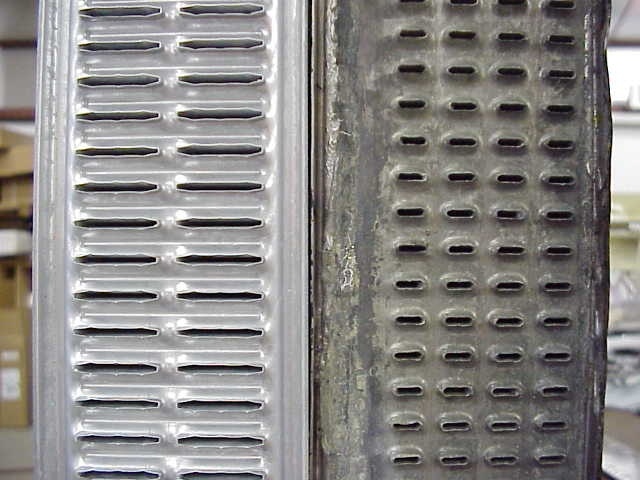

When I was looking for a rad I came across a BeCool rad with 2 rows of 1" tubes, it advertised for motors of 350hp (mines a 456 in thr neighborhood of 500). After looking around it seamed that this was the standard with aluminum radiators that advertised higher hp ratings so I snagged it up. I ran a 165 stat for the first year with a shroud and a thermo clutch fan with no issues. Now I'm running A/C, a 185 stat and dual electric fans. I can turn the dial on the fan controller and immediately start watching the temps drop so it's proven to be more that adequate.
Which one do ya think will cool batta?

Well, I just installed a 3-row Champion because I needed "something" and the price was right. I used to work for a radiator company....and I'm not a mechanical engineer, nor understand this 100%, but I've got a pretty good grip on it.
You are trying to move heat out of your engine. Heat starts from the explosions in your cylinders and has to move through different materials. Heat travels through these things & in this order.
1. Explosions in cylinders
2. Engine block (& pistons/heads too, but we'll ignore that for now & focus on radiators)
3. Antifreeze/coolant
4. Radiator tubes & fins
5. Outside air around us (this is where your engine heat eventually goes)
Each of these material that heat is traveling through has different properties such as "coefficient of thermal conductivity" (how fast heat can move through it), "specific heat" (how much heat that substance itself can hold) and similar properties, all of which play a part in how heat moves out of your engine.
Now to the good part.....radiators & fans. One big factor for the radiator is "surface area" of the tubes. If you ignore the edges of the tubes, you can think of it this way.... two 1/2" tubes = one 1" tube for surface area (pretty close anyway). The more surface area of radiator tubes you have, the faster heat can leave the radiator, whether that's two rows of 1" tubes (2 x 1= 2) or 4 rows of 1/2" tubes (4 x 1/2 = 2), the surface area is roughly the same. Also, the fins help transfer heat out of the radiator tubes, so the more "surface area" of fins you have the better heat transfer you get, just like the tubes themselves. This is referred to as "number of fins per inch" in the radiator industry.
However, the last factor is air flow. The faster that cool air moves past hot radiator tubes, the faster heat is transferred (that's why a breeze feels good on a hot day). More air flow through the radiator cools better. Adding more tubes & fins helps transfer heat for sure, but the heat has to go into the air in order to leave the metal of the radiator tubes/fins & without any airflow, not much heat is transferred. The more tubes/fins you add, the worse your airflow will be.
What you're looking for is the best balance you can find of enough tubes/fins (or rows, if you will) too maximize the heat flow out of radiator, but not so many tubes/fins that you block off the airflow. If you had a 100-row radiator it wouldn't cool worth a darn because you'd have about zero air flow, even with a factory fan + two big pusher fans, you just wouldn't get that much air through it and it wouldn't cool. You could have a helicopter blade for a fan (TONS of air flow), but if you only had one tube total in your radiator, that wouldn't cool too well either.
Somewhere in all that there is the "perfect cooling system" with the most tubes/fins you can get that don't slow down air flow too much & the biggest fan you can find.... but finding that perfect mix is beyond my understanding. I haven't even mentioned antifreeze flow (water pumps) or how copper transfers heat better than aluminum which transfers heat better than brass or how the temperature difference factors in (antifreeze temperature vs. outside air temperature).....ever notice how you overheat in the summer, but rarely overheat in the winters?
A radiator seems so simple...but dang is it complicated. If I had more money & fan shroud fabrication time, my gut instinct is to try one of those aluminum two row radiators with the 1-1/2" tubes. That's 3" of tube (total) and with only two rows, I bet the airflow through them is pretty good.
