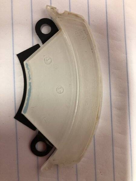

69 Runner with column automatic. Was rebuilding the column and the clear plastic piece that has the "P R N D 2 1" on it has no black letters left. I tried painting them back on, but they look crappy. Tried vinyl and they would not line up. How do I restore this to something functional?
It sits right in front of your face all the time, so I don't want to be mad every time I drive if it looks crappy.

Unfortunately the letters are raised ever so slightly on the plastic which is why they are hard to paint. If they were more raised it would be easy or even if they were recessed it would be easy, but these are just slightly raised. It makes it very hard to paint.

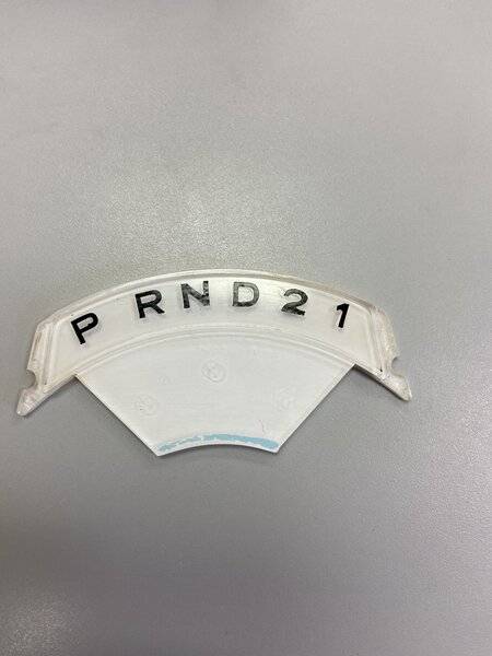

Lesson Learned: Always talk to the car guy at the print shop.
He heard what this was for and he went out of his way to make it happen. I am sure it took far longer than he charged me for ($16), but I am so glad he took the time. Here it is done in under a day.

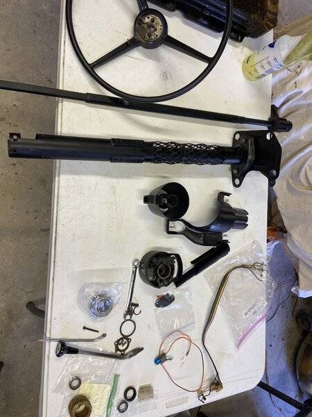

Now I just have to clearcoat it and include it in this process.... (Fun weekend project)
Thanks for following another adventure of my "Saved from the Crusher" build.
