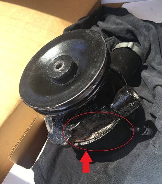

Hi everyone, I was wondering what options I have to fix this leak in my P/S pump? Seems to be leaking from the housing pretty bad.
Uhh....replace it with a rebuilt one ??? :poke:
Looks like you need a new seal kit if it’s leaking between the cast iron and the tin metal. Make sure your tin metal is in good shape not all dented up around the outer edges or it won’t reseal. Kits are about $10 easy job you can most likely do yourself. Let me know if you need any tips on how.
FYI that’s a federal pump
I chased a leaking TRW pump for decades until I took it apart, cleaned it thoroughly and eliminated the reservoir o-ring. Loaded the ring groove with plenty of ultra black, assembled it and let it sit for over 24 hrs. Trimmed excess material with a utility blade, repainted, reinstalled and a year later not a drop of a leak.
Thanks, I just took the housing off yesterday to clean, and also used ultra black, but on the o-ring. Will see if that works, if not I might try and take out the ring, clean, and only use ultra black.

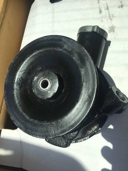

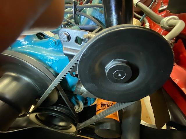

Dom, don't want to hijack your string, but I have the same Pump, it looks, in my 66 Coronet. I may have a leak on the Front behind the pulley. If so, can one buy rebuilt ones or new ones? If so, what does one shop for? I started the car today and it works, but I see a bit of fluid on the front just behind the pulley. Here is Mine. Best, B.
Sounds like the shaft seal needs replaced. They are cheap. Would need a pic of the back to confirm Federal or TRW. Also the front shaft, solid or hex if it’s a TRW.

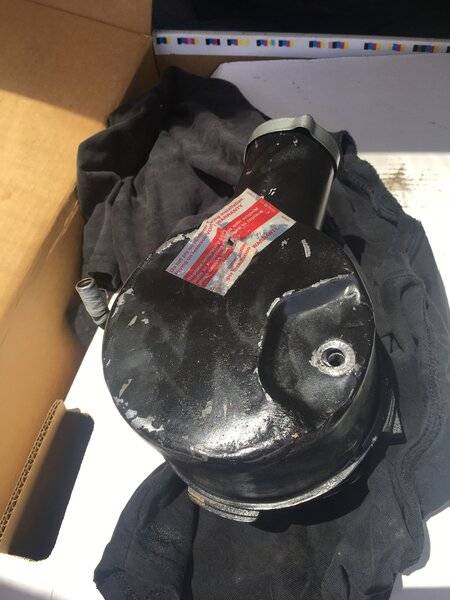

Not easy to get a good pic from behind. Perhaps this one will help. Here is a front shot. Thanks in advance, B.
I have rebuilt several TRW pumps over the years. Not too difficult. Getting the slippers and rotor back in the pump housing can be a little tricky. Also slippers have to be pointed in the right direction or it won't pump. FSM has the procedure.

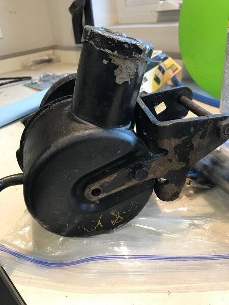

Here is a pic of my Power Steering Pump before doing the clean up. Thanks to SureGrip, we can see it is a TRW. So, it looks like Dom's is the Federal and mine is the TRW. Are TRWs easily rebuildable? I wonder what that 68... number in yellow means?? Best, B.
Wonder what that 68.. in Yellow means?

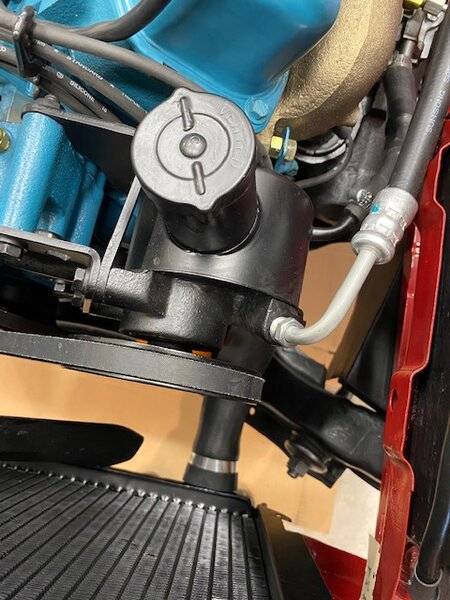

My power steering pump worked great and just leaked so I replaced the large o ring seal and the shaft seal. It was super easy if you have the tools. I have read that pumps don’t typically go bad so the rest of the seal kit went on the shelf. What I did fixed my issues on both pumps. I did not see a need to completely take mine apart.
