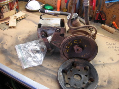

p/s pump
The Federal pump like in this photo. It has the large metal cap. Pulley will differ as this is a Slant 6 set up.
I got mine from Summit I believe but good luck on the pulley unless you have the old one. Make sure of shaft hole diameter. Are you looking to replace or add on? There are about three versions of the Federal pump early to late. Best thing to do is find used one for your year and have it rebuilt that way you know all parts match. I went through this about three years back. It was a PITA

Pump sizes? That's determined by engine size, and should show the differences in the service manual. Without actual sizes in my head, one for 6 cylinder, one for SB, one for BB. Federal and TRW. This for a 63?
4 pumps used
.94L Key shaft Saginaw (oval filler tube)
.96L Solid end shaft 4 5/8” ID reservoir TRW Small Pump
1.06L 3/8” threaded internal hole shaft 4 7/8” ID reservoir (The Federal)
1.20L Hex Hole shaft 5 1/8” ID reservoir TRW Large Pump
TRW Fitting can be different between pumps. Federal pumps and there were three variations based on output pressure did not start until about 67. So a correct pump would have been small TRW as I stated earlier in a post. Also, Mounting bracket is different between TRW and Federal. Google that and you can get pictures.
