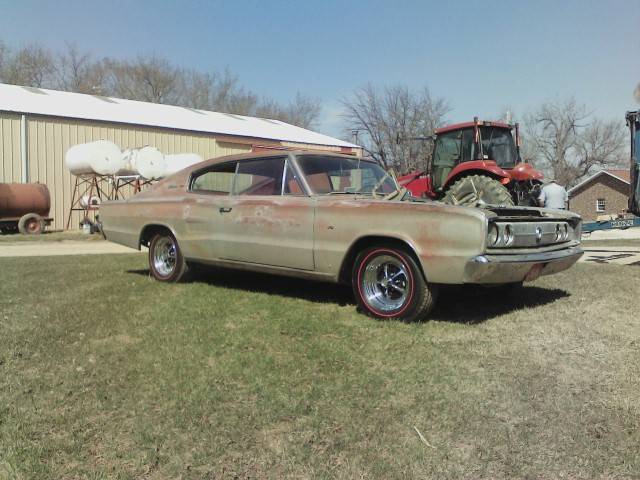

I use a 235/60/15 on the front of my Charger. If the torsion bars are cranked down a bit, they look awesome. They do look smaller if the bars are up like stock. I run a 275/60/15 on the rear so it has a bit of rake. Pics for reference.

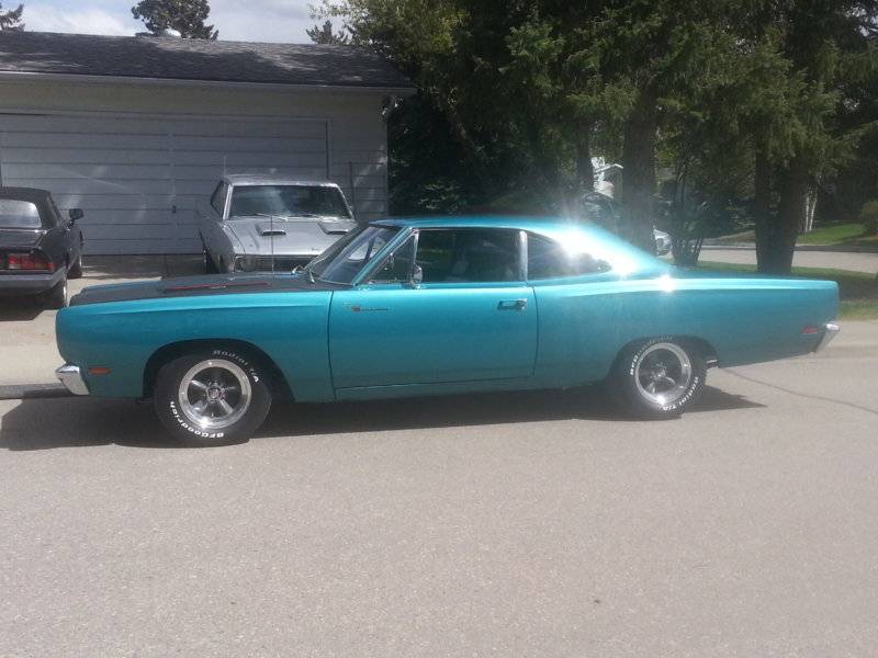

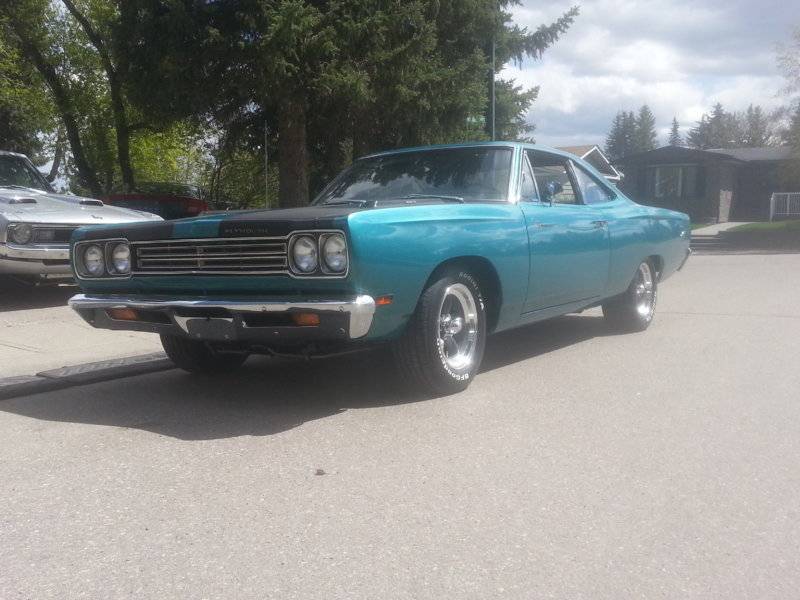

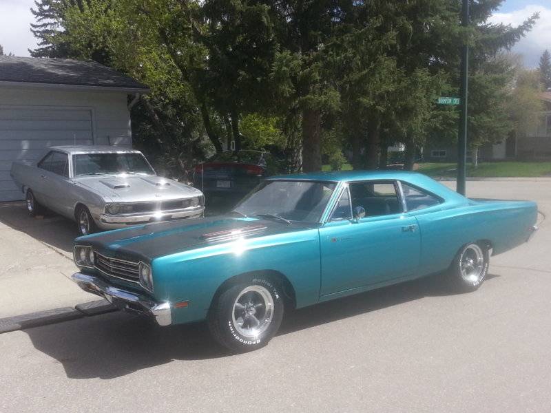

275/60/15 on 8 inch in the rear, and 225/70/15 on 7 inch for the front work well.

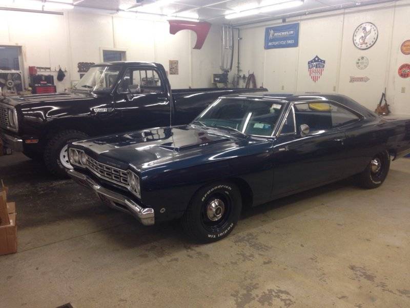

I run the police wheels on my Runner sometimes. That has 215/70/15 on the front and 235/70/15 in the rear. Here is what that looks like.

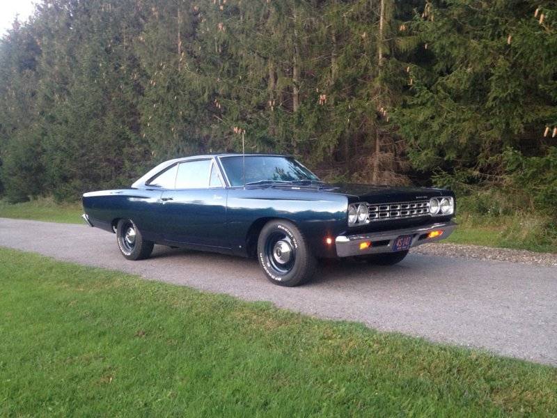

Here's my 66 with 225/70r15 on 15x7 rim all the way around

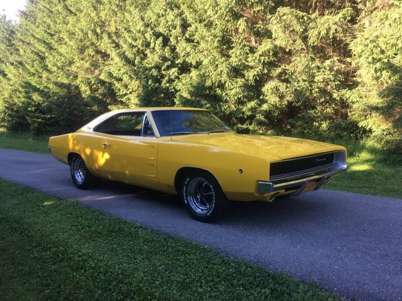

I have 225/70x15's all around on my '69 r/t with no issues. 235's are about 1/2" taller so you shouldn't have any issues on the '69. I do run 235/70's all around on my '65 coronet. I had to pull the front fender corners out a little for clearance but I have 15x7 torquethrust's and they stick out a some.
