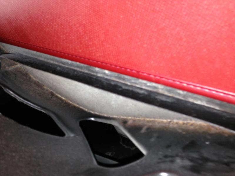

I ordered a package tray from legendary auto and an gonna get it recovered. When i test fitted it there was a 1/2" gap on both sides where the sail boards go. Is the package tray supposed to fit tight against the two pieces of metal sticking up on either side of the tray. Thanks
I got mine from Mega Parts and it was a tight fit side to side. It actually bowed in the center and I had to put weights on it for a few days to get it flat. Looks good now. I installed on a 70 Charger
The headliner goes down the sail panel and tucks under the package tray so takes up a little space and can hide a small gap. Not sure about 1/2"
The pic uploaded sideways but you can see the gap
Same on both sides. Should it be closer to the upright metal edge? Thanks
