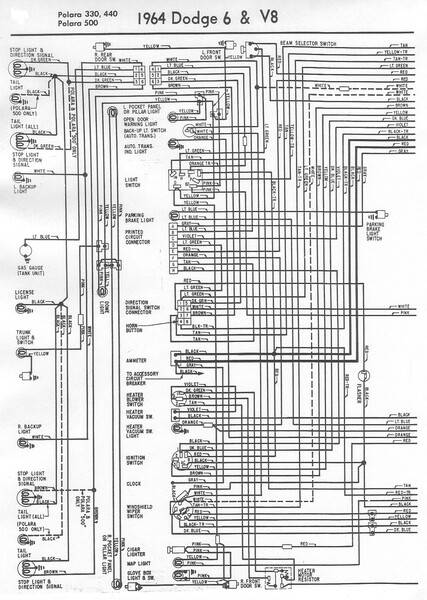

Here is the wiring diagram, Lets see what is going on:
I have the wiring diagram. I rewired the car with a new kit and fuse panel from "Keep it Clean". I'm also using relays for the headlights and electric fuel pump so I get a full 12 volts at all times. This isn't the first car I've wired so I'm not a novice when it comes to this, but I'm not an expert either.... especially when it comes to diagnosis.

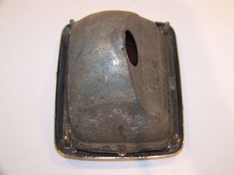

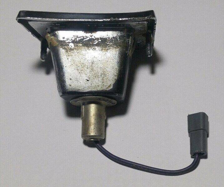

This your backup light and brake light assemblies?
