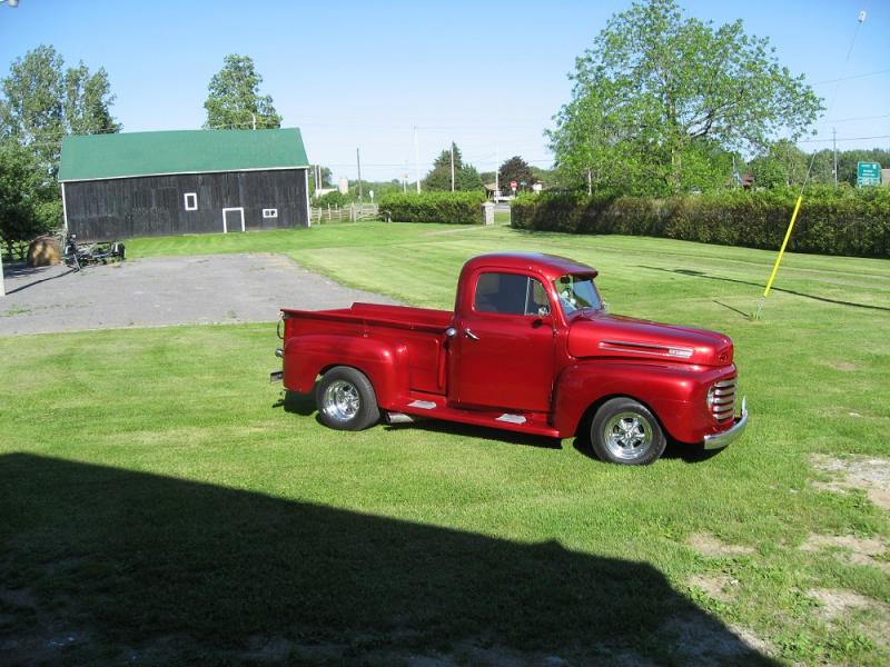

i don't know a lot about paint. usually whatever the paint guy is using, but i had a truck done and wanted something special and used house of colors. wow, what a result. looks about a foot deep. its not cheap but if you want that special look i recommend it. a paint job is the first impression people will have of your ride. my next "keeper" wheels will be the same brand. as for "just" a paint job i would guess any of the big brand names would be similar. each painter will have his own preferrance.
