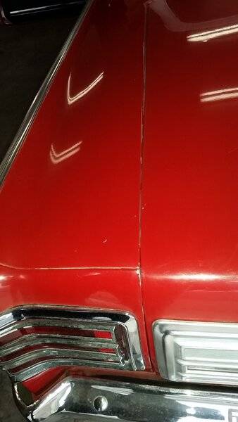

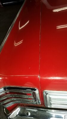

paint store Screwed up but not taking any blame, paint we got is a gm color. I think they had multiple orders and screwed up, im posting a corner pic of my car and the color. I did some research and the pp1 in 66 has three different ppg numbers so we are having 3 different pints made to see which one matches the best.
This is the previous panit job?
I had my PP1 redone in 98(standox base/clear) and I think they matched it to a 78 BMW red.
Are they using waterborne?
Yes that was the original paint, they are using omini paint.
