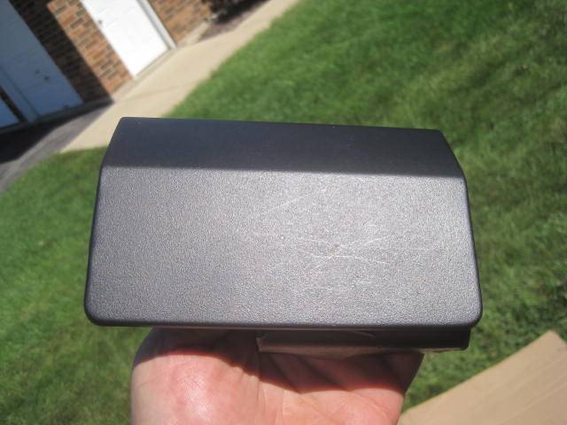

I’ve pulled the instrument cluster on my 72 SSP and the metal dash has several scratches when I purchased the car. Has anyone found the correct dash paint? Mine is black and I want to match the OE matte finish that is on there now.

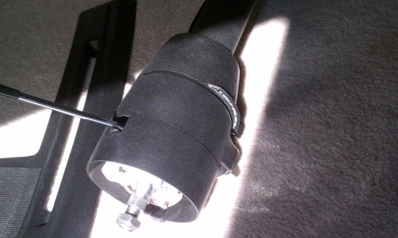

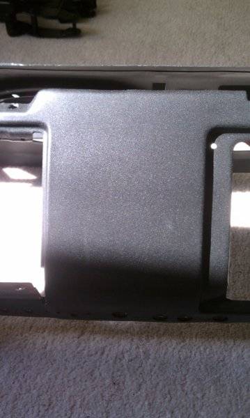

Here is black on the glove box door, dash, and steering column for your reference.

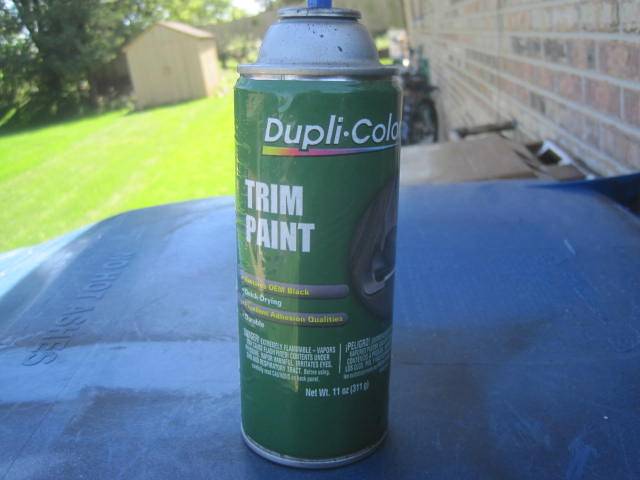

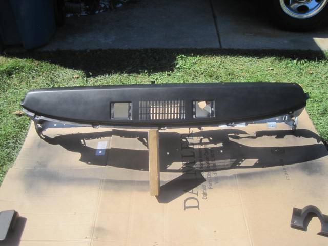

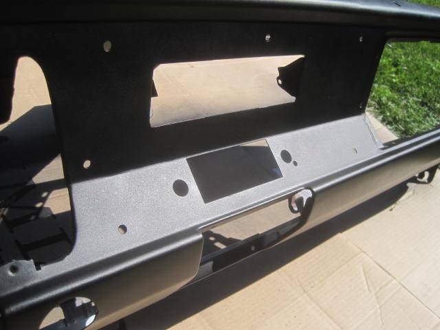

I used this trim paint from autozone and it worked great. The get the spackle texture you have to practice with spraying distance
