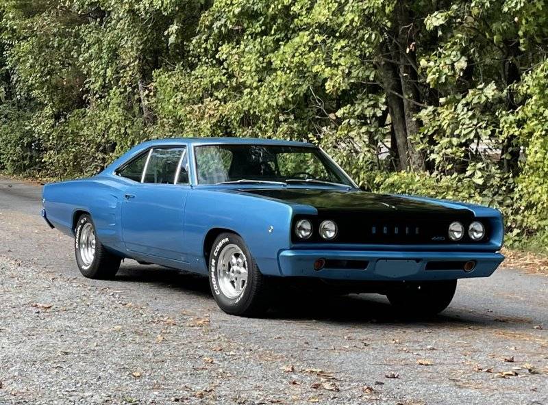

Shake down went much easier the second time. She is back on the road. QQ1 with single stage Hot Rod Black on the hood.
