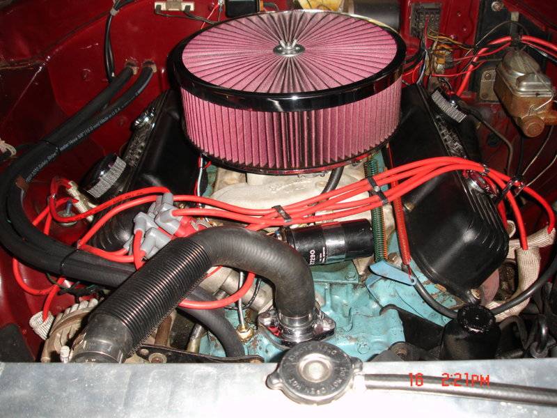

Does anyone sell turquoise engine paint in a can you can brush touch-up with not a rattle can?
go to your local Mopar dealer they will get it for you it is a spray can, part number P4120752 (Turquoise) I just spray it into a containter then I use a brush
just call a friend about motor paint, he is in the Mopar restoration business, he says he uses Frank Badalson and Bill Hirsch paints to spray motors with a spray gun. He says that they are a great paint to use. It comes in a can and you can brush it on the motor, you might have to add a reducer and activator to the paint to.
Eastwood makes the Turquoise in a ceramic engine paint that comes in a can. I believe it is intended to be thinned and sprayed, but I'm sure you could brush on as well.
