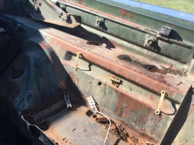

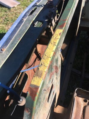

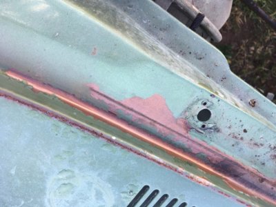

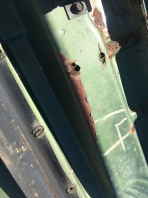

I got a parts car over the weekend and when I started stripping it, looks like it was painted burnt orange then green. Factory stickers over the green. Only appears to be on the front. Must have been a Monday.

We bought a original owner 68 Road Runner that was green (not that the color has anything to do with it)She said it was never painted or even touched up. So it was tore down for restoration. When we started sanding the faded thin green,blue paint started showing up on the roof. Only on the roof. Only on one side.Our thought was yep, some one goofed.

If it was the whole car I'd say it was done in Orange , probably last of the run sitting on showroom , person said if you change color to green I'll buy it !
I've seen a few cars like that
,But the oops factor sounds more accurate!

Over the years I've had 3 cars that had a different color paint under the original paint in the engine bay. I think they emptied their guns when changing colors.
This is correct. I have had Mopars that showed this clearly. The factory used a paint gun with a long hose connected to huge containers of paint. There would have been valves to switch between colours. The colour of paint was switched, and the paint in the hose had to be used up before the new colour came through. When the factory painted the cars, they began by painting the engine bay, then the other jambs, and then closed things up, and sprayed the exterior. That is why you will see a different colour under the engine bay. Also it is possible, that the guy with the gun accidentally started spraying the burnt orange, realized it, and said "Hey Joe, its supposed to be green not orange", and the valve got switched to green and he carried on.
Also, I will add, that the factory painted the interior colour first, so if a car was white, with a blue interior, for example, the blue painted door surfaces were done first, then masked off, and then the exterior was painted. No masking was done when the interior colour was sprayed, so a lot of the surrounding areas would be that colour before being masked off. So when sanding through the exterior white paint, one will find blue underneath. Very common to see the interior colour showing through at the door hinges.
Chrysler baked the paint, and probably baked the car after the interior colour was sprayed, then masked it, then sprayed the exterior colour, and baked it again. That is why you will see the exterior colour peeling in the jambs sometimes and showing the interior colour. The exterior colour did not adhere really well to the interior colour, because it did not get sanded prior to the exterior being sprayed, and therefore, it did not bite into the interior colour all that well because it had been cured by baking.
