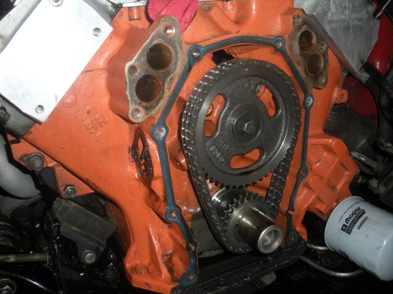

That chain looks a bit sloppy

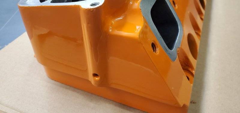

I paint all my aluminum engine pieces. Though they have all been primed with epoxy primer first. Then sprayed with urethane. Lasts forever. These heads were smoothed and the Indy logo filled with bondo.

I just painted it all engine color to hide the Aluminum :)
Doug
Wow, those look liquid!
Aluminum starts to oxidize in a few hours, so they need to be scuffed with ScotchBrite and Simple Green
