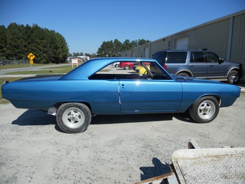

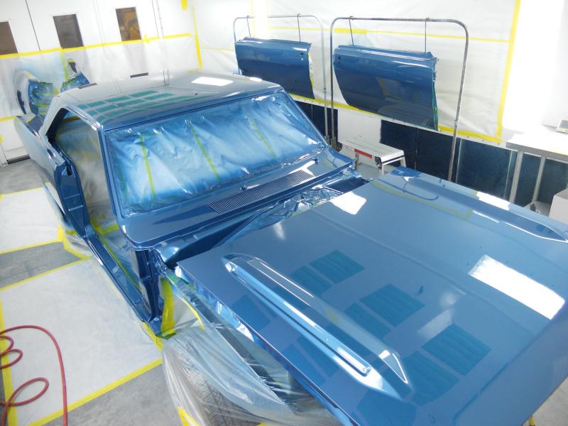

Painting them apart and oriented (vertical or horizontal) as it will be on the car, you should not have a color problem. First do a spray out card to count how many coats are needed to get full hiding and the true color. Then, be sure that all pieces get the same number of coats. If it takes 5 coats to get coverage on the card, put at least 5 coats of color on everything. More coats is okay, less will bite you.
