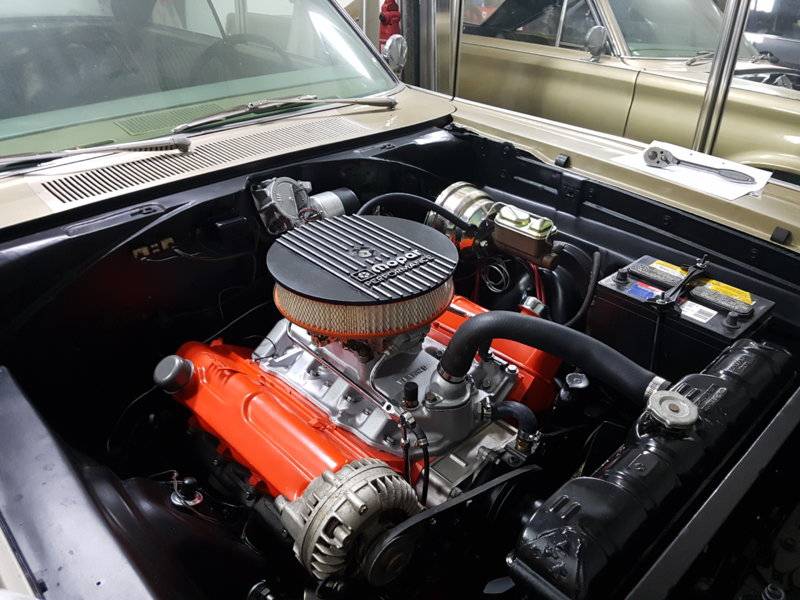

Hey guys, my car is citron gold with a Chevy-esque black engine bay.
I painted the engine bay at the start of the restoration when I intended to paint the whole car black, but later changed my mind and decided to keep the original color.
I want to re-paint the engine bay the correct color, but don't want to remove the engine. I can remove the radiator and everything on the firewall, but has anyone successfully re-painted their bay with the engine in place?
I'd hate to replace a decent black paint job with a crappy body color paint job.
What do you reckon?

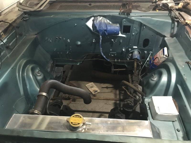

I rattle canned my engine bay. Bought 3 cans of special mixed paint. Im not really happy with the results. But I needed garage space so I did it to get my engine back in it and off the huge run stand.

Thanks for all the replies fellas - you've pretty much confirmed what I thought, pull the engine to do a proper job.
The first photo was an early one, to show the contrast between the black and gold. The car's been on the road for nearly 2 years now, and for me, removing the engine is a big job (I'd vowed to only do it again if the engine blew).
There's also the front side of the radiator support that I also painted black - I'd have to remove the grill and all the headlight wiring to access that.
Considering all your replies I might juat leave it black for now.
