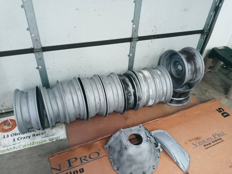

I am painting a set of steelies for my 69 GTX (R6) and wondered if both sides would have been painted from the factory or would have it just been the outside? Thanks for any responses.

Most, if not all factory wheels are painted on all surfaces, from what I have dealt with. Just prepped a dozen for my painter to have at...
