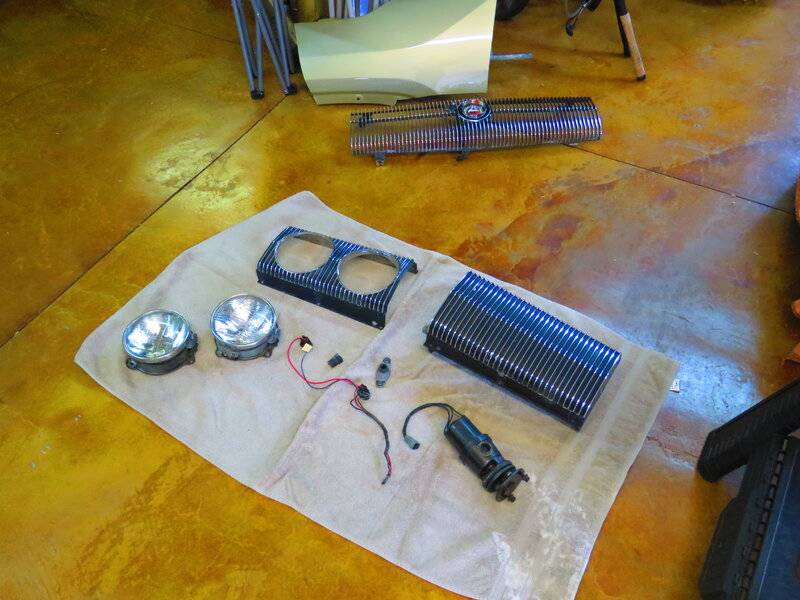

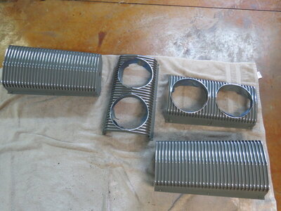

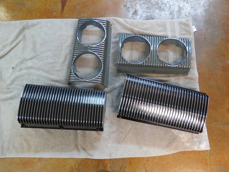

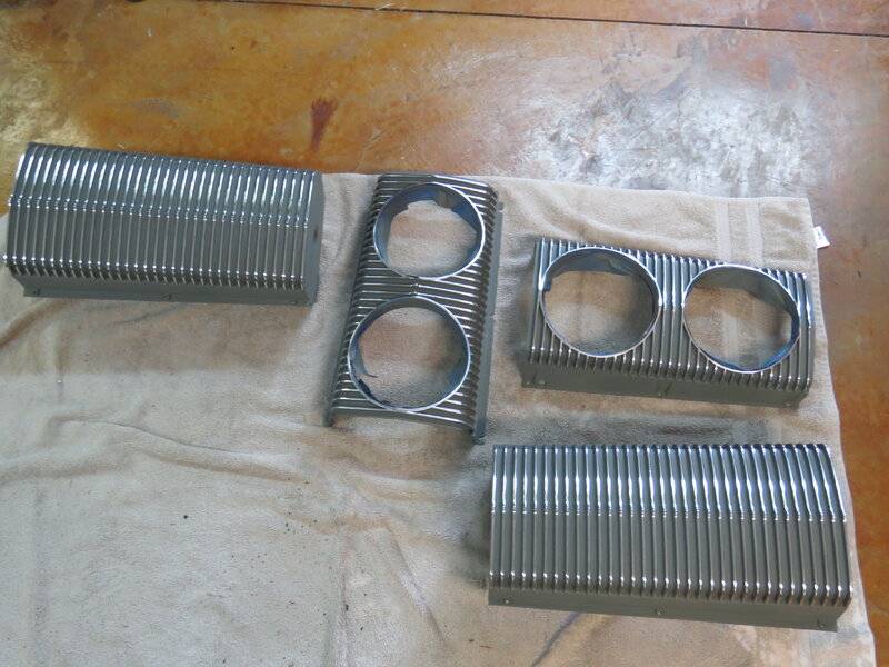

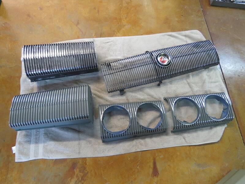

With the car painted, I had to restore the headlight buckets. This is really tedious work. 1st - filed off all the raised pot metal noogies with a small file 2nd - Painted with self etching primer 3rd - Remove primer from chrome 4th - Paint black 5th - remove paint from chrome again. Wow -- this is tedious! Note: I found it best to remove the paint off the chrome using lacquer thinner on a rag tight against my finger. It worked best just after the paint flashed off and was still wet.

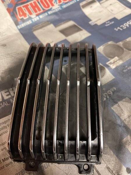

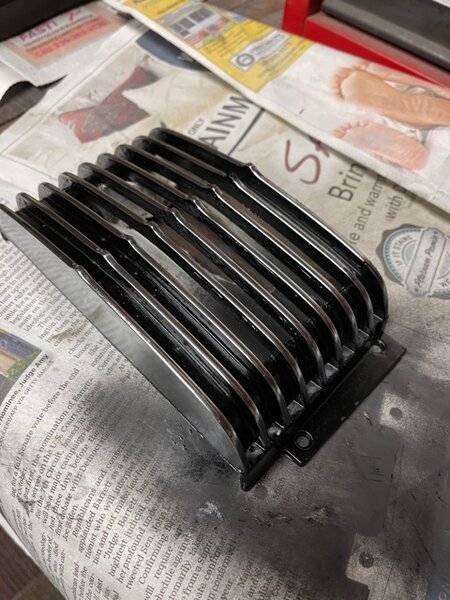

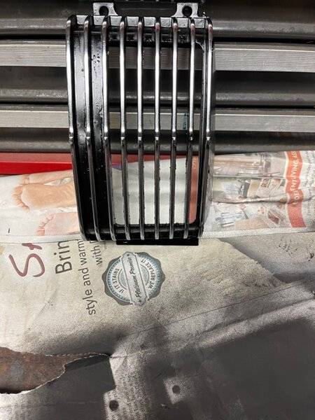

Great job Maxrat, they look great. I started mine and did as follws:
I cleaned the chrome first, light sanded in-between with green scotch pad, then put a film of vasoline (with a old toothbrush) on the chrome before I sprayed the paint. After I sprayed the paint, I took a rag a wiped off the vasoline. Looks good to me

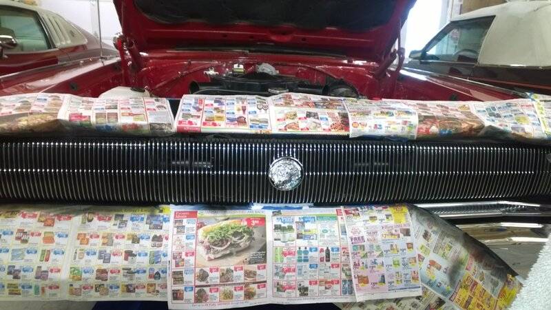

Actually fairly simple if you tape everything off and use lacquer thinner to wipe off the black from the chrome.
A light coat of polish is all that is needed on the chrome. I do it every car season.

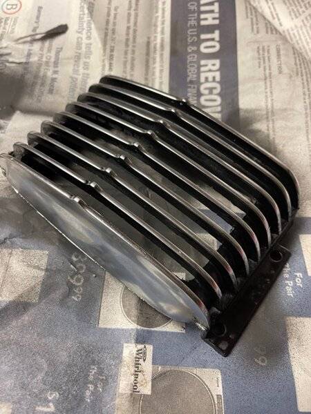

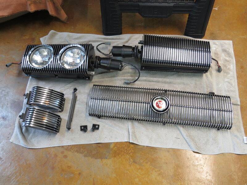

The pesky bugs and stones make a mess of the black. So I do the same as you, a little sandpaper on a paint stir-stick, sand and repaint. Then wipe off the polished chrome with thinner. Don't forget to hit the headlamp motors too.
Another shot.

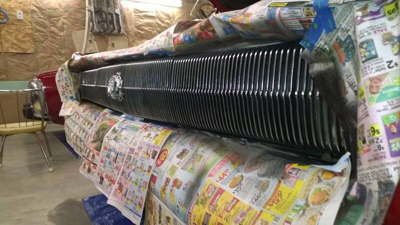

Nice job. Yesterday I worked on the turn signal covers. Today I'm going to work on the grille. Headlight buckets are done.

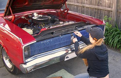

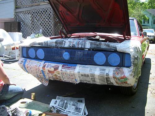

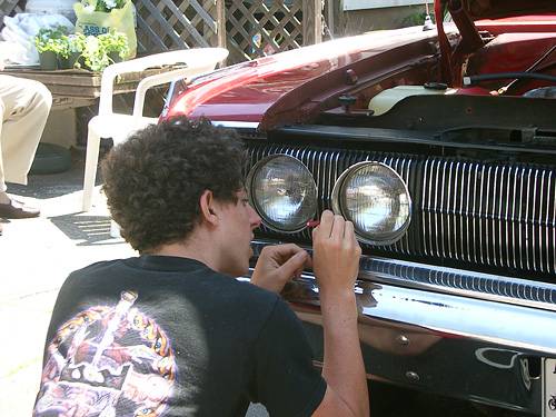

Kids wanted to do something with the car so...Family Project, (14 years ago)...
I gave the kids some painters tape, 1/8" for the small stuff, and told them to have at it.
It didn't take them very long to mask it front and back. I hit it with the black, and they removed the tape.
They enjoyed doing it.
