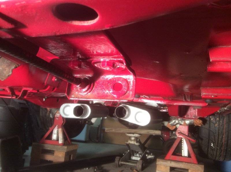

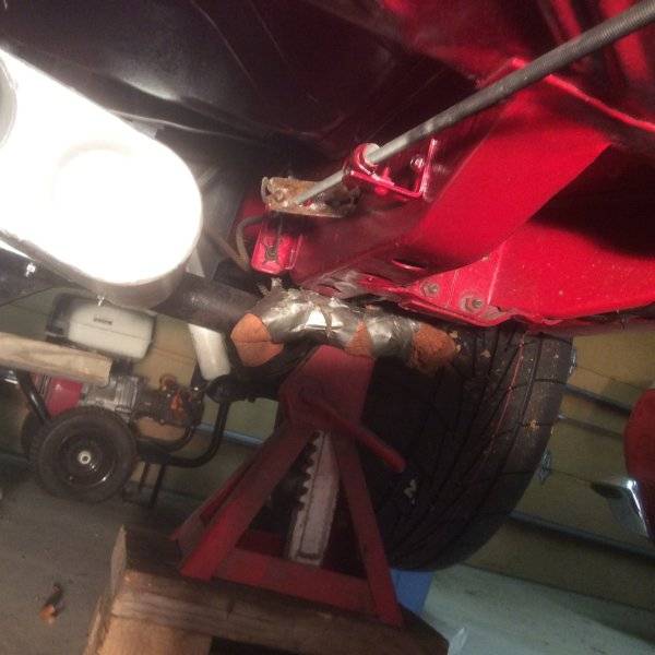

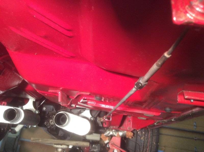

You may have the e brake bracket for later brake cables on driver's frame rail? My 65 Dodge did and used the long cables. You need to mount front to trans crossmember . I used a connecting nut with a jam nut 4th prc and a threaded to reach adjuster with the 2 cables. You need to support the threaded rod. Might be a better way but it works. 3rd pic front cable mount. 1 st and 2nd pic is of L bracket to hold up threaded rod. Used a plastic pipe with tubing clamp for rod to go through, no rattle. Had to fix adjuster that turned 90* after photo.
