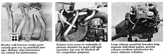

I am pretty sure those are the exhaust manifolds that come with 30" crossram setup. The block off plate covers up the port for exhaust heat to the bottom of the intake to help carb operation. Quite often, one sees the intake setups for sale, but hardly ever the exhausts. They could have been prone to cracking, since they are cast iron. There is a lot wrong under the hood. Newer Bendix power brake booster and master cylinder, probably supporting front disc brakes; a good upgrade for safety. Later cruise control that looks like the same system I pirated off a '70's Cordoba for my '64 Polara. This has newer motor, judging by 6 bolt valve covers. The mid-'50's wire wheels look nice, but were passe', by 1960.

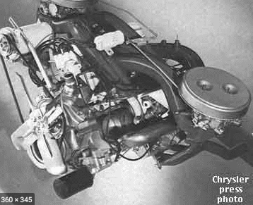

I’m no expert but those are 1963 300 J exhaust.
the brackets are reproduced.
https://www.ebay.com/itm/324758884901?hash=item4b9d235225:g:El8AAOSw3q1hHlNh
Yup...

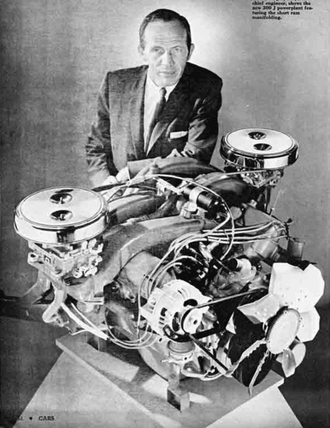

The passengers side looked like a tube which made me think home made, live and learn. Nice manifolds. I see in the Chrysler pictures the intake are short ram. Did long get same exhaust manifolds.
According to this article Short ram only....
http://www.forwardlook.net/forums/forums/thread-view.asp?tid=29144
Which is kinda cool cause I thought Pop's 64 300K Vert was a short ram car but wasn't sure, it was sold in 73 (for $100) & I couldn't be sure... But I know it had the header style manifolds so that confirms it was a short ram car....
