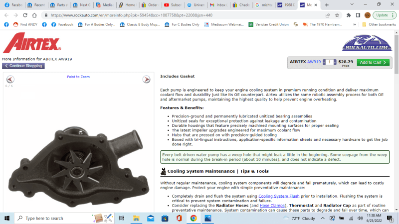

Airtex Aw919 is a 8 vane. The application says non a/c but it has the 8 vein impeller in it.
Yes, the OP is aware that there are 8 vane pumps for non a/c cars. He is looking for a 6 vane designed "for" a/c cars.
Boy I messed that one up. I had a few 6 vein pumps up. It's a pain opening each description and going through photos to find the backside view. And all just to help a member. Yes @GMP440, I saw a couple 6 vein pumps on Rockauto's site. They looked like the same pump and they were brands I have never seen before. You can check it out yourself. Good luck.

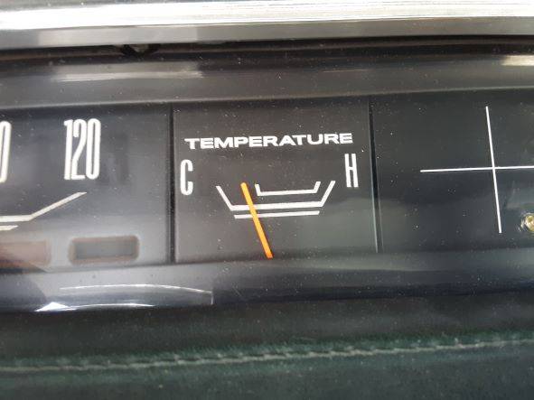

Hello everyone. Sorry I didn't report back sooner. I replaced the water pump. What I had on was a 6 vane pump. I replaced the pump with an 8 vane pump.
None of the parts stores and water pump manufacturers have the 6 vane water pumps for a/c cars.
Did alot of research on this. They all produce pumps for non a/c cars. Dayco; they list both a pump for a/c cars and one for non a/c cars. Both pictures in their parts catalog show both pumps being exactly the same with 8 vane impellers.
The pump bodies that are used are correct for an a/c equipped car. It has the bypass fitting and heater hose fitting. Next to the heater hose fitting the pump is recessed to accept the bracket for the R-V2 compressor and it has the 8 vane impeller.
I ran the car and it cools just as good as the 6 vane pump I had before. With the a/c on cooling is very good. Where the guage needle is sitting is where it always is and has been for as long as I had the car.
So, what's going on,the pump manufacturers are just producing 8 vane pumps that will work for a/c and non a/c cars.
I hope this helps others in this same dilemma.

Real world results! I'm surprised both cooled about the same. Is this at idle and all speeds? Thanks for sharing.
