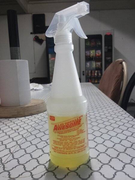

I discovered this as a alternative to my mineral spirits in my parts washer tank. I just sprayed this TOTALLY AWESOME onto a old 340 bellhousing sing and let it soak in, then brush it lightly and squirt it with a hose or better yet a pressure washer. And wow! It had over a 1/4" of nasty grease and it just washed away. And non toxic! You can find it at dollar general or Walmart. And it's inexpensive.
