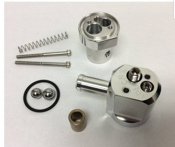

I use this. It's expensive but it's a great piece. Takes a 3/4 id grommet
http://mewagner.com/?p=444
Same one I got that resolved oil blowing out of my valve cover breather. TUNEABLE and that allows for several performance enhancements. Amazing engineering, quality, materials, and tech support. Getting one for my wife's modified 421 TriPower GTO.
:lowdown: M/E Wagner PCV valve
My cam has very low vacuum so I needed something that would work with that, this worked perfect and you don't have to guess if you have the right valve for your engine since you tune it yourself
I have to the best of my knowledge and the opinions of others a 292°/.509 can and I get around 12" of Hg at 950 RPMs.
I can't praise the M/E Wagner PCV valve enough!
