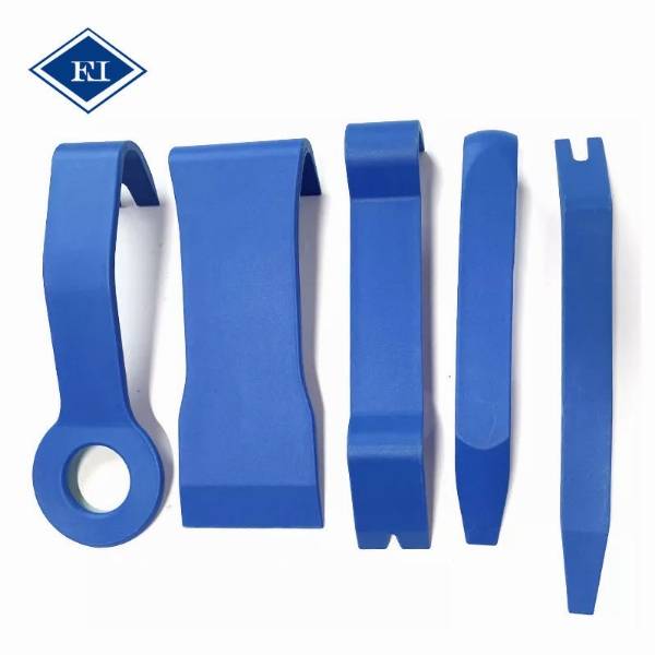

Use a nylon pry bar to pop up the trim.

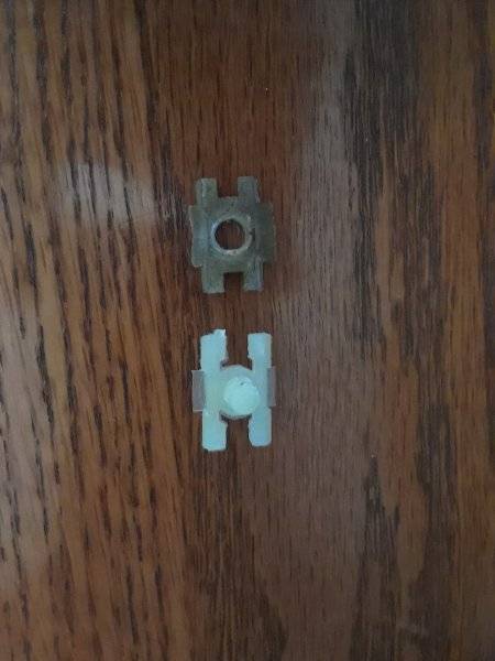

This is what you are working with that attach the remainder of the trim:
And you are going to need to purchase some new ones since most will get damaged in some way popping them.

If you can, look up towards the mouldings clips on the top of the door from inside. You should see white pins/clips. If the mouldings have been changed you might see studs with nuts, those you would have to unscrew.
If you have the factory clips, you should be able to gently pry the moulding off.
Those Moulding clips.
If they aren’t brittle. You can carefully drive the pin out with a small flat nosed punch. Carefully squeeze the prongs from underneath and push up. And you can reuse them, I try to use as many original parts as I can.
