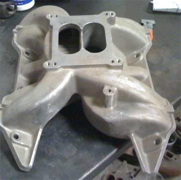

In the quest for a stock appearing engine... "What intake is that??" It's got no logos, it doesn't have that funky mounting boss like a Performer RPM... "What is it?"
Yup a little cutting grinding & texturing to make it look un-altered... Once it's painted Turquoise it'll be somewhat stealthy...

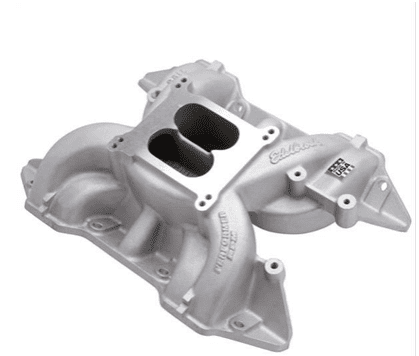

Vs a new Performer RPM...

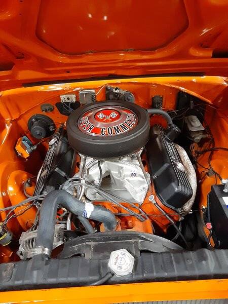

Dennis H ran a Performer RPM with the stock air cleaner under his bulge hood for years... I looked at it pretty thoroughly cause it's what I plan to run on my Coronet...

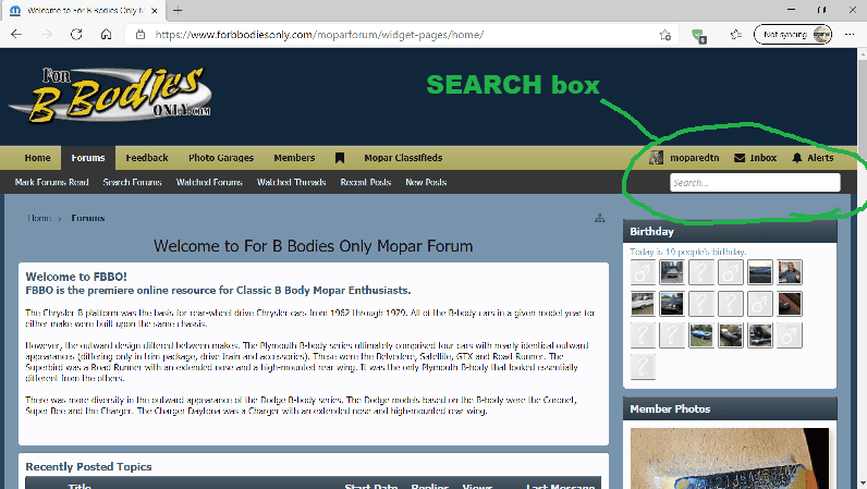

This is a recurring question, seems like. I know it's been hashed out many a time on here,
measurements and all.
I'd suggest utilizing this site's "secret weapon" - the SEARCH box!

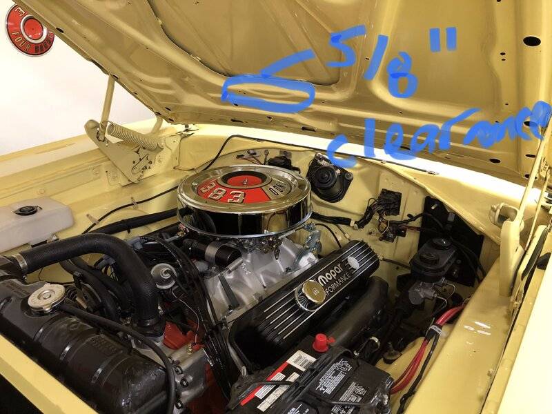

I have this set up but in a B motor which has 3/4” less deck height than the 440. I can use the stock Mopar performance unsilenced air cleaner & base, which in not a drop base in design, and also have to use a 2.25” tall filter in order to give the air cleaner enough hood clearance. This combo gives me 5/8” clearance at the tightest spot which is at the back of the hood where the curved cut is part of the design. The filter is a wix, don’t have the part number but if you look up a common Mercedes air filter that is the one. 13” x 2.25”. The stock filter height is 2.75” for your reference.
So: 440 engine is 3/4” taller than mine, and the drop base air cleaner will drop it about an inch, therefore those two elements cancel each out. Then you are left in a similar scenario to me. You will need to source a 13” drop base, I think Mancini has them if not pro-form makes them for Ford applications but you’ll have to buy the whole air cleaner and toss out the lid.
