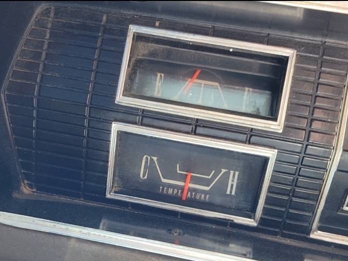

What makes you think your fan clutch is not working? A factory big block came w a 180° thermostat. It "starts" to open at 180° and is fully open at 195°. They were designed to operate just fine at 195°. It is not too hot. If you are getting detonation from a stock engine at that temp, there there are other issues, timing, carbon build-up on pistons etc... I live in AZ w typical summer temps of 115-125° and am getting no detonation from 10.5:1 compression 496" engine at 195°. Here is where factory gauge is at 196°
What makes you think your fan clutch is not working? A factory big block came w a 180° thermostat. It "starts" to open at 180° and is fully open at 195°. They were designed to operate just fine at 195°. It is not too hot. If you are getting detonation from a stock engine at that temp, there there are other issues, timing, carbon build-up on pistons etc... I live in AZ w typical summer temps of 115-125° and am getting no detonation from 10.5:1 compression 496" engine at 195°. Here is where factory gauge is at 196°View attachment 1176900 View attachment 1176900

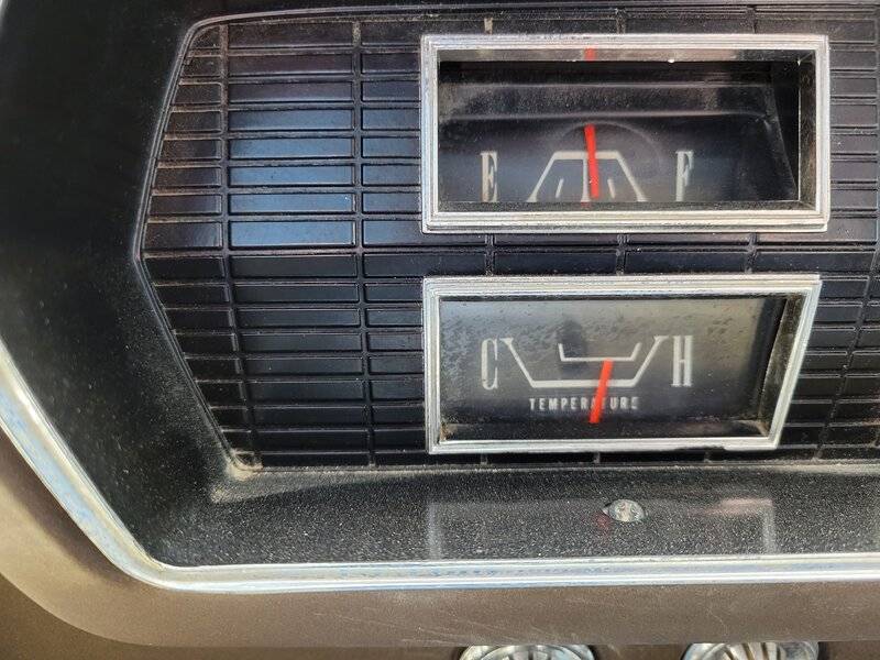

My car on interstate is at 174°, 196° in stop n go traffic w a/c on in extreme heat and 222° max while sitting after a long drive. But goes down quickly once moving again. No boil over, no overheating etc. Here's the gauge at 222° still in the normal range.
