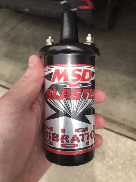

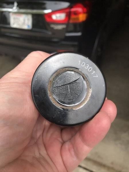

My epoxy filled MSD
Lasted one day on the highway going to a car show before it literally blew the bottom out
I have had more issues with coils in the last five years then the previous thirty years all together
Chinese JUNK

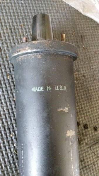

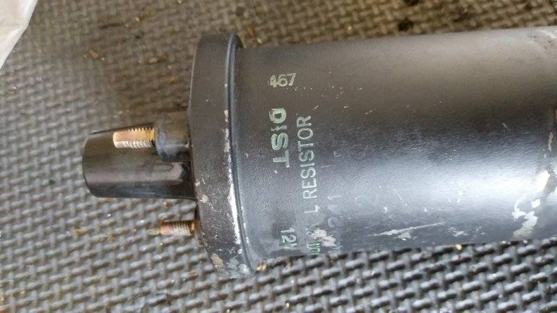

Found this in the yard this morning on a 68 Polara with a 383HP. Still had the original late '67 coil that tested good on the ohmmeter. Maybe I'll just restore this one and keep the chinese one as a spare.

So I cleaned up and tested the date coded '68 coil from the yard, put it on the car and it runs just as good as the new aftermarket unit. Go figure. This one has been laying sideways for 55 years, no oil leaks.
As long as there is no layer shorting or oil leakage, no reason why the coil would not perform as well as the day it was made...
