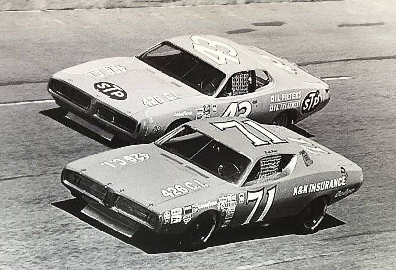

The Baker fender looks stock. The Petty fenders have been modified. Look at that curve!
From this angle, the Petty fender either droops downward or inward - narrowing the front end. (or a combination of both)
What do you think??

Yes the Petty cars did exactly that. The hood and fender leading edges were also flattened to match the bumper upper profile to eliminate the gap that exists on stock versions of 3rd gen Chargers. By 73 there were tons a subtle changes being incorporated into "stock" car builds. The game was rapidly changing.
Quarter windows are different, so maybe they're different years. Wheel openings were larger on the 73-74 versions.

The 1971 72 Chargers have the side window swoop up to the top of the roof vs the 73 74 Chargers where the window is longer at the bottom
Also on the 71 72 cars the doors are taller on the back edge to meet the shape of the window so 71 72 doors will not fit 73 74 cars
Harry Hyde ran the 71/72 Charger body due to the smaller rear quarter window allowing less air into the car. Also note how wide the panel is from the interior to the window to try to prevent air from entering the car. Things like that lead to a NASCAR rule limiting the width of panels to the interior. The 71-72 superspeedway car got wiped out in the "big one" at the 73 Winston 500. after sitting out a lot of the 74 season (when Baker left K & K) due to rules that killed the Hemi, Harry came back with a 74 Charger that had the "opera" window quarter windows to limit the air entering the interior. Rpbert Gee (Dale Earnhardt's former Father-in-law) was the bodyman for K & K, and a lot of his "metal massaging" is not as noticeable as others.

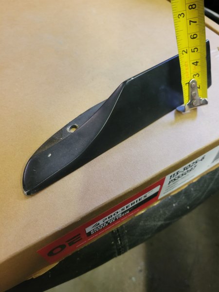

An inch and 3/4 for the production one
The #71 is a reskinned Nichels built 69 Daytona or 500.
Notice the filler pieces by the "A" pillars to the cage that #43 does not have, being it was a new ground up build.
Same reason the aluminum piece on the door top to main hoop of the #71 1969 cage is wider than that of the #43.
The 1971 and later Chargers are a lot wider than the 68-70 Chargers.

An inch and 3/4 for the production oneView attachment 1882140
That looks nothing like the strip I saw on the 66 Charger in the pits before the race. It was no more than a flat strip of alum painted white screwed onto the trunk lid and was given a Mopar part number that Nascar supposedly asked for at the local Dodge dealer to verify it was stock offered part, that was concocted up I believe at the race track that week to reduce the fastback lift issues on the Charger at speed.
The first spoiler I ever saw on a race car was on Ferrari's 1961 at Sebring, seemed like at that time they were called "duck tails"? Spoiler was not part of the lexicon yet.
They made no sense to me at the time other than to create drag, but the point here is they were the full width of the car and likely 4" tall, and why the Charger spoiler in 1966 seemed so odd and noticeably small.
Petty's Charger looks like a 73-74, and Baker's Charger looks like a 71-72,
just judging by the side window frame/profile.

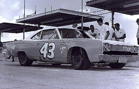

In 68, Petty had the front bumper pulled forward to get more air over the car and beat the template that went to the edge of the hood. Easily seen in this photo!
