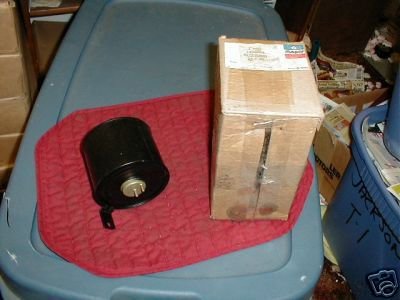

The PG kit doesn't come with the Trico vacuum can. The correct one can still be found in boneyards, early 70s C bodies. I've got several in my parts stash.
