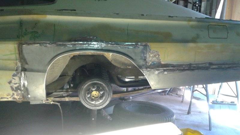

About to put a new quarter on my 66 Charger and I am wondering if anybody has photos of the process. I'm sure it's pretty straight forward, but seeing photos helps me do things I have never done before.
Good article in Mopar Muscle (IIRC) a few years back.
Are you butt welding?

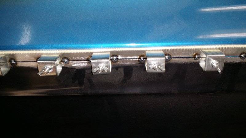

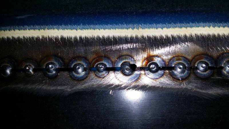

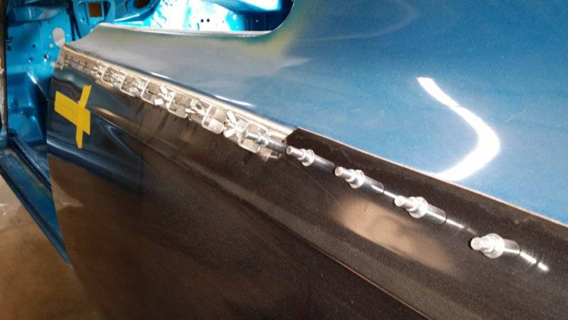

Here are some Using the clamp kits from Harbor freight and a bunch of Cleco's, I positioned the
quarter perfectly before starting to butt weld the quarter on. Different car, same procedure!

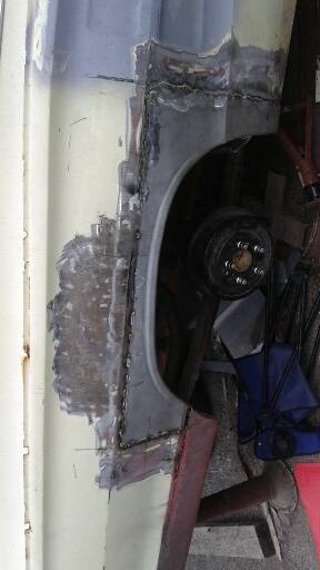

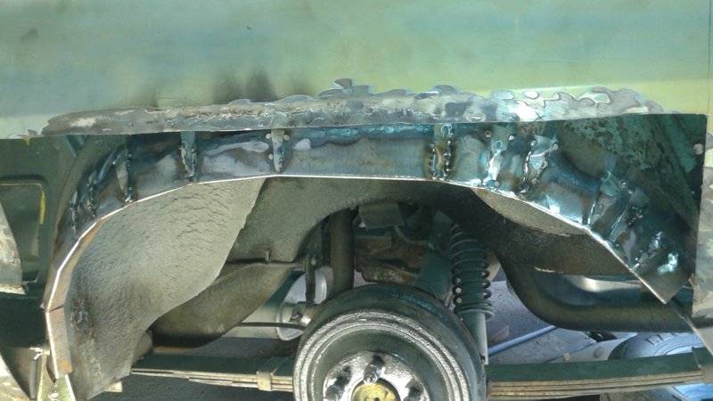

the panels i had came with car but did not have lip all the way around fenders and the lines were way off there are some more pics in members projects brads 66s

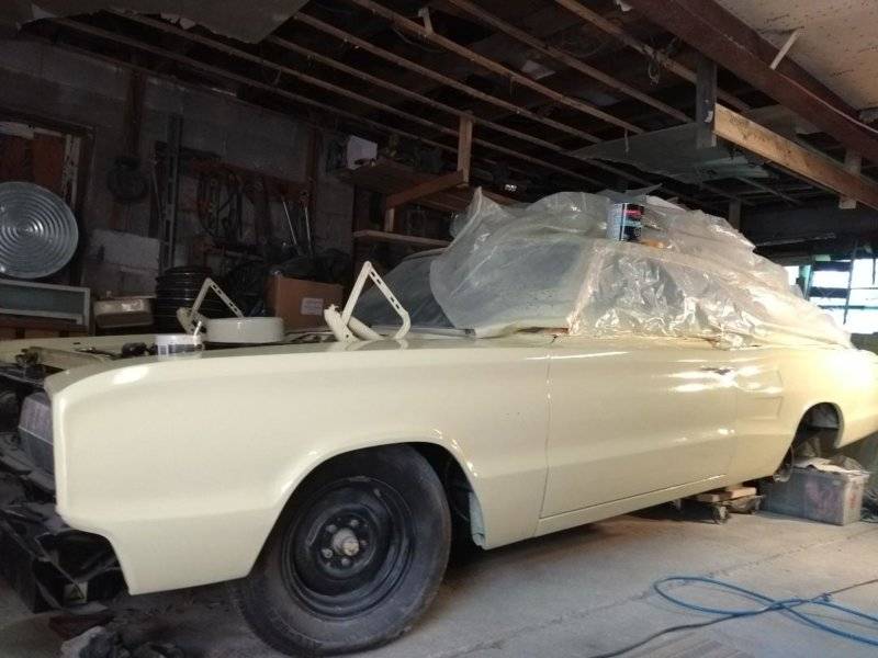

Late to the party but,,, different car, different procedure!
