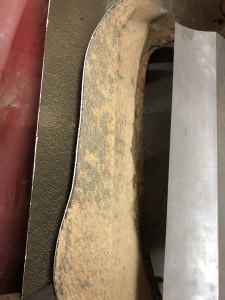

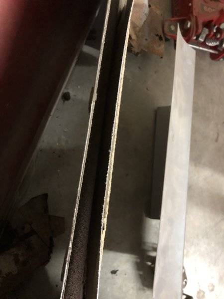

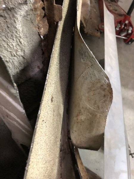

Upon further review, there’s not much wiggle room
89DC5C4B-D019-4C2F-8261-96AC438D6737.jpeg E4332558-2077-4ABB-A24C-93477BCF3745.jpeg 25831525-0478-4506-8176-03074A677F4A.jpeg
Thank you very much for the pics. That's basically what I had pictured in my head. That's plenty of "wiggle room" for me. I can take it straight up off the crease, and box out the top of the well. I'll most likely move the springs and inner wheel well too.
