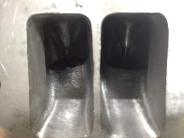

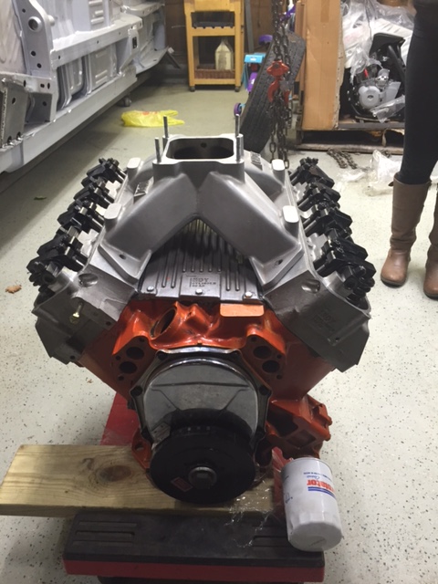

So I picked up a new motor this weekend from a guy on eBay....Looked like a really good deal and so I jumped on it. Now that I got it home and started thinking about it maybe it was not the best choice...I had all intentions to build a fast street car that would see occasional track use but 90% of the time would be fair weather street driven, cruised, and car showed. The problem is I'm not sure I can bring this motor down to an acceptable street car with such big heads, Cam, and Intake. BTW its going in a 66 satellite Auto trans w/borgeson steering and Hydraboost.
What would you do? See specs below:

I would instal a cam with a duration of 230-240 @ .05 range you'll be much happier!
To me, it does not seem too bad....
Your duration is a bit high 278/281
Usually anything over a 255 is more aggressive that typical street driving.
High lift too.
You might suffer in Vacuum.
NOTE: Your Rockers are only 1:5 ratio which is okay
So: Too me it appears the engine was set up for Street/Strip.
Everything else sure seems expensive and sweet!
Change the CAM as 69 GTX suggested.

I think the heads are worth more than $900. The Indy 440-1 kit is like $4000 before porting....
Also let me be clear I'm looking for an 11.50 car or better out of this...
Any other options other than basically scraping this motor for a steel 906 headed/ Hydraulic cam/ Dual Plane intake havin/ almost stock rebuild?

Just install the right converter and rear gears. Forget the daily driver idea.

So I talked to Hughes racing and they said that if I can get him cylinder pressures (just the way it sits) they will grind a cam that should work with a 3500 converter and 390's.
So im going to install trans, stock converter, ans starter and see where we at...

That's the best plan in my book. Then see how the street manners are and if you need to sell the heads, well hopefully by then I have enough cash saved up. :)
I see where superbee ski is going with this, I think the heads are worth more than $1500, I would sell the top end, heads, intake, aluminum valley tray, head bolts (I believe they are different for indys?), with the cam and lifters, etc. Then buy a cheap set of decent heads, a streetable cam, 850 holley, and an intake that matches your cam choice...
So if you are back into the motor for $5000 (which you should be around $4000 after the carb) you are in good shape...
