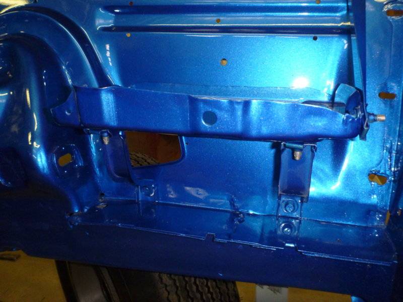

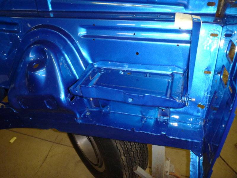

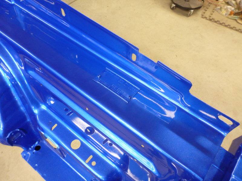

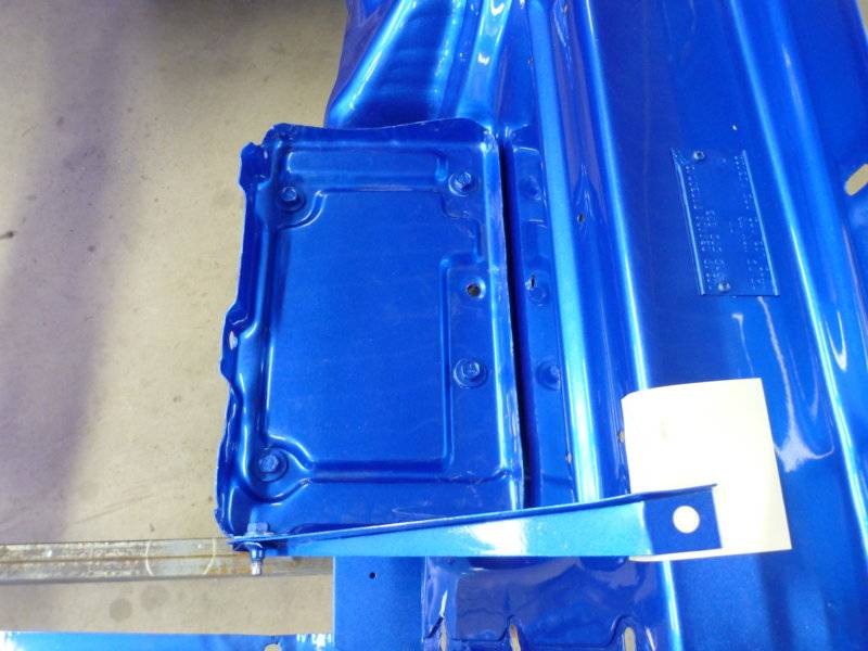

Can anyone attach a couple pics or the driver side inner fender at the battery tray section?
Interested in the part where the bolt goes through the middle of the tray.

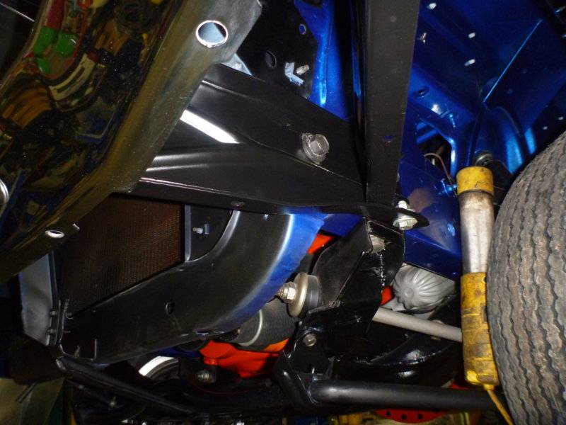

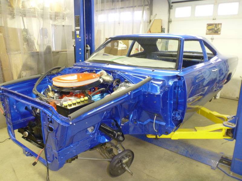

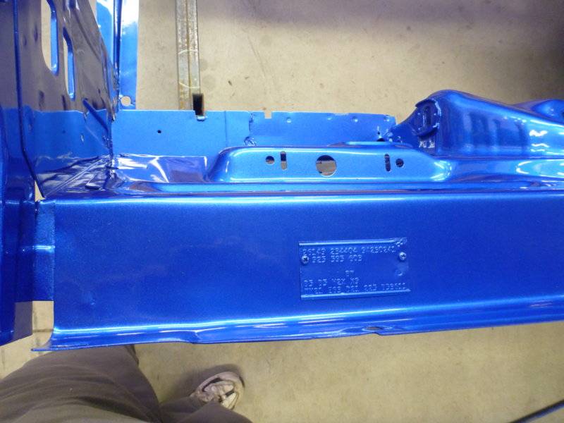

Not exactly sure what you are asking.. but do these help?

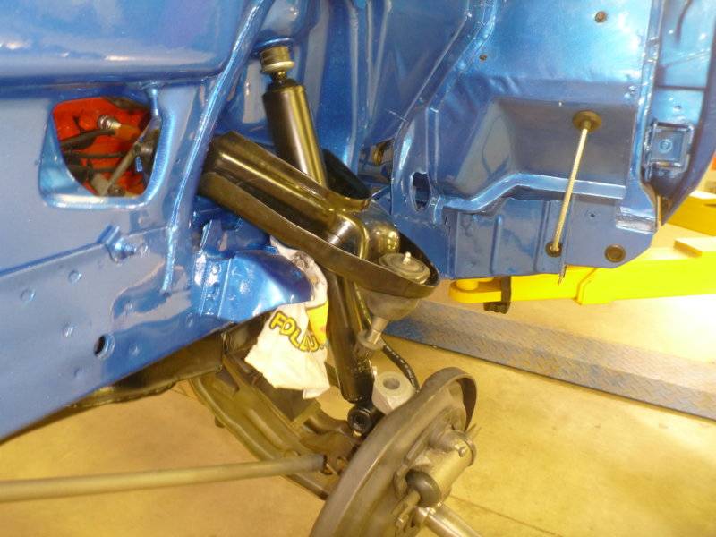

Do you have a pic of the opposite side of it like in the wheel well area!
Those are exactly what I needed thanks so much for taking the time to post them!

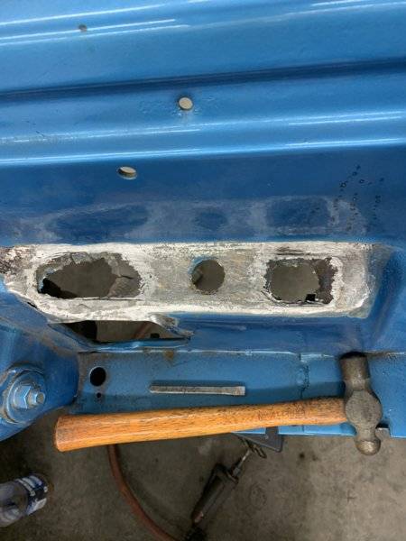

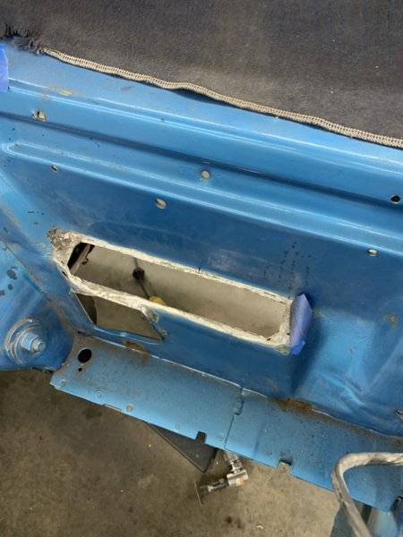

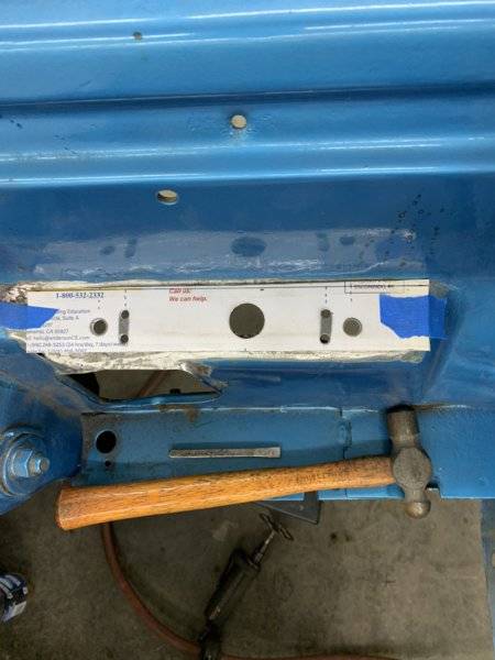

Unfortunately someone has patched over the slots and holes for the clips:realcrazy:
so now I’m gonna need to find a patch piece to replace that part.
If you don’t mind I would like to grab one of the photos for reference to find a patch piece.

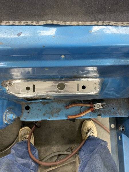

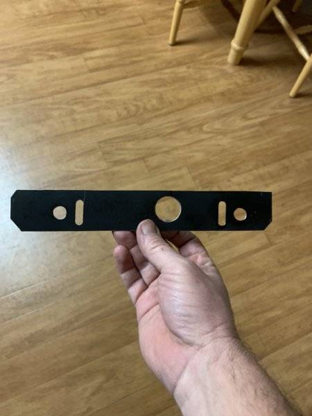

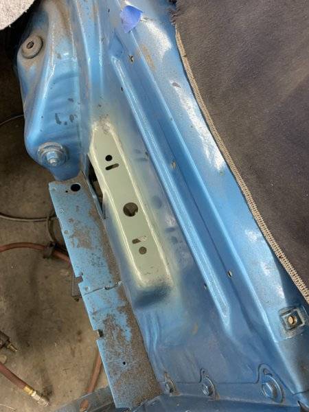

Thanks to dadsbee and my good friend I got the battery tray area sorted out.
I got a tracing off my friends inner fender and made a patch piece and welded it in.
