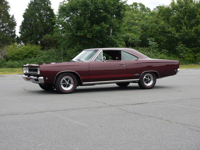

I have used Eaton springs on two cars...a GTX and a Superbee. I think 2 inches is a bit much unless you are sticking some rubber bigger than a 275-60 15 out back. 1 inch will give the car a slight rake, to the untrained eye will almost look stock, particularly as you adjust the front torsion bars.

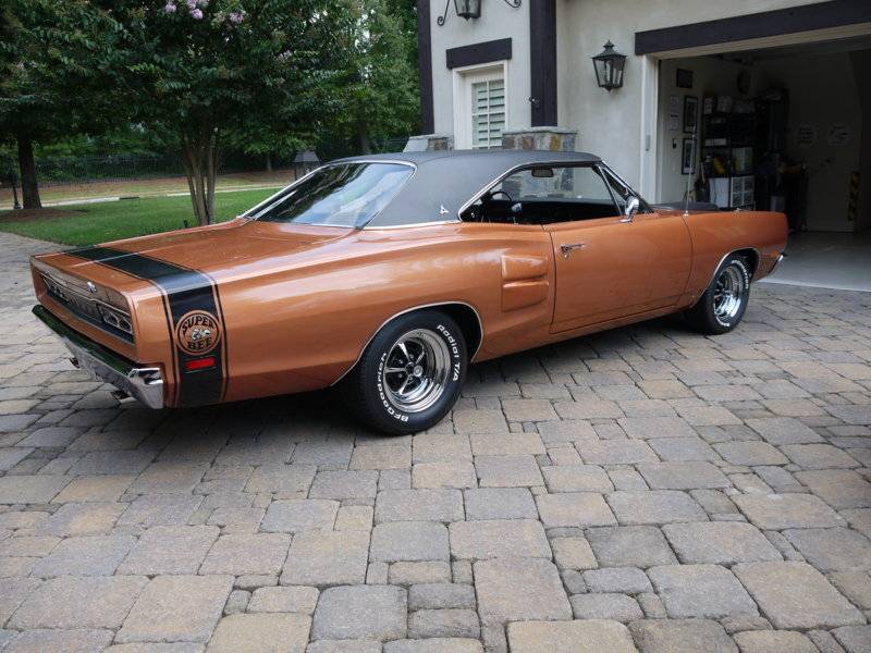

Got the heavy duty springs +1” from ESPO. When I put them on I thought I made a big mistake. After raising the front a bit it looked better. After driving it they settled quite a bit and after a year dropped another 1/2”. I’m real happy with them and love the ride. From the ground to the wheel well, just above center of tire, it now measures 28 1/4”. At the time of the picture it was 28 3/4”. I replaced a set of new “stock” springs and they were to bouncy for me.
