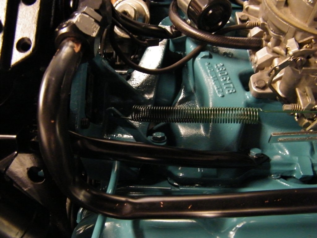

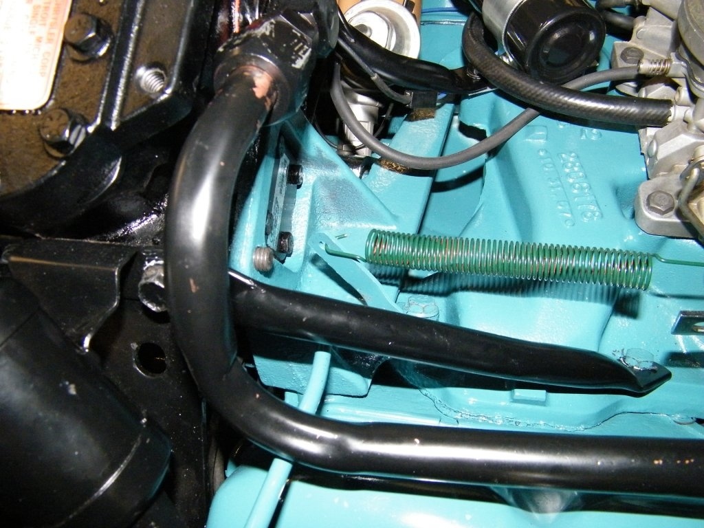

RC, which Year car? I have one on my 68. The photos above show what it looks like.
The one I remember bolted right to the AC compressor.... Classic MF207
FWIW RC, the bracket that 68 shows is the same as on my 66-300 383 w/ac. I don't know if the heights are different then a 440? It would make sense that they are all the same as Mopar liked to use interchangeable parts when possible. Good Luck

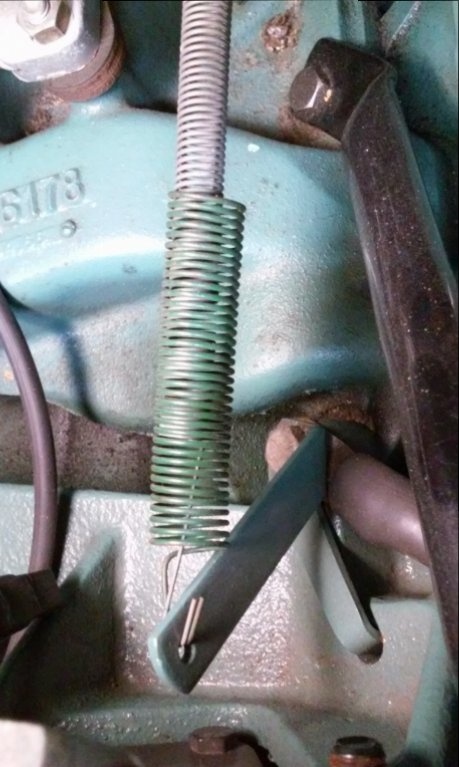

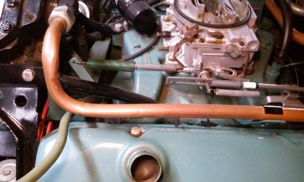

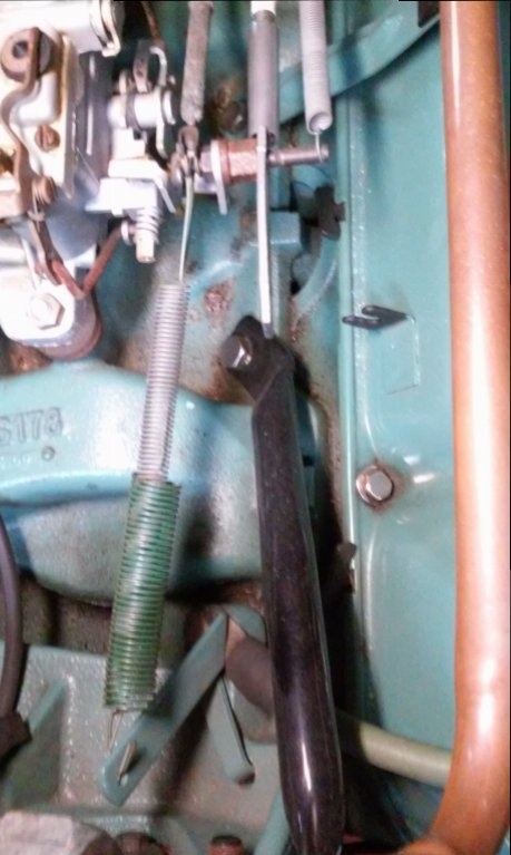

Here's mine. Prior to this picture, it was bent at a sharp angle towards the center of the engine. Looks like I'll have to take it off and bend it straighter
Plus you are missing one spring there. There should be two (in case one breaks).
