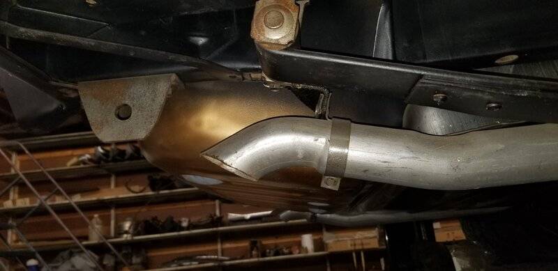

I'm looking for pictures of what the rear tailpipe hangers & mounting hardware looks like for a dual exhaust 66 B-body. Can someone be so kind as to post a couple?

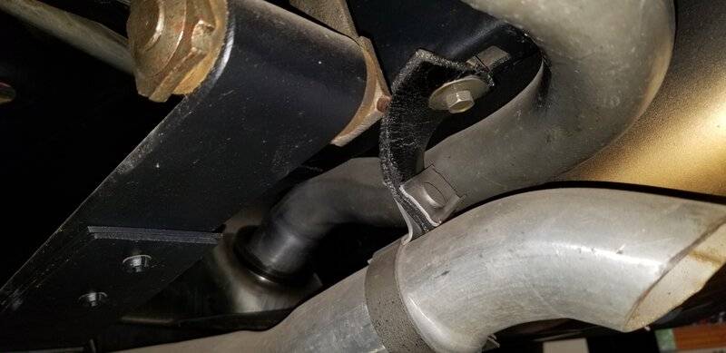

This is correct for 67, I think 66 is the same.
My bracket is backwards in this picture. These were from Gardners Exhaust, supposed to be correct. This is a 67 R/T, not 66.

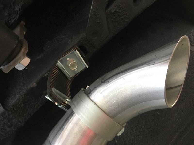

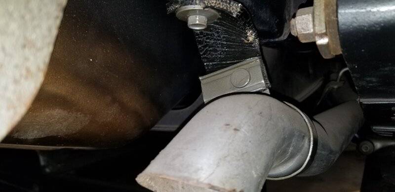

If I may, on my ‘66 they bolt up into the frame through a U nut. Also, there are left and right sides. Looking at each hanger straight on from the back of the car, the metal part of each hanger bends outward slightly. I’m not sure if the repos are manufactured with a right and left but this is what’s on my car. Hope I explained this correctly.
