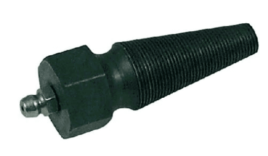

https://www.amazon.com/Lisle-55600-...ZNP6FWC44NN&psc=1&refRID=T1P08B326ZNP6FWC44NN

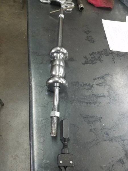

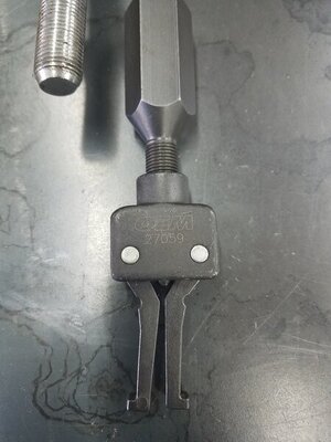

I have a tip for my slide hammer that works excellent.

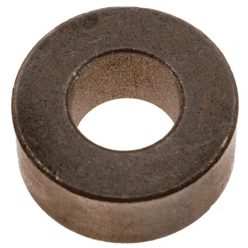

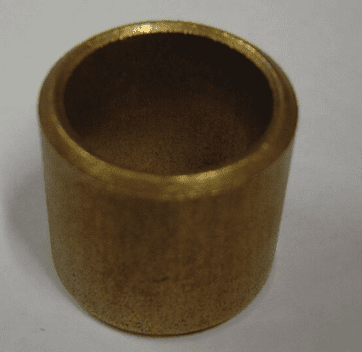

thing is, grease, bread, whatever works great on Chevies & Fords cause the pilot bushing outside dimension is allot bigger than the inside dimension... So there's lots of surface area to act as a piston... Not saying it won't work but the deal is stacked against you when trying to remove the Mopar bushing.... The tool I linked above allows the whole diameter work as part of the surface area...
First a Ford bushing, the Chevy & last Mopar..

i have one similar to 7318 OTC works great my friends have used more than me
I bought the 55600 tool from Amazon. I tried the 2 jaw style. Does not work, nothing for the jaws to hook under. It just slides right out. I hope this tool works. All else fails, can I use a pilot bearing in the crank where the TC snout goes and leave the old bushing in place?

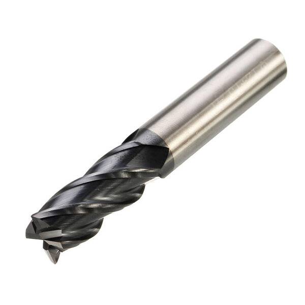

I used a small endmill in my air grinder and cut it in two spots to make it paper thin. Then I wacked it with a small chisel and it broke in half. The thing is oil impregnated bronze material so it isn’t like it’s hard and you can’t break it up and get it out. It’ll come out no problem just give it some patience.

I used a small endmill in my air grinder and cut it in two spots to make it paper thin......
