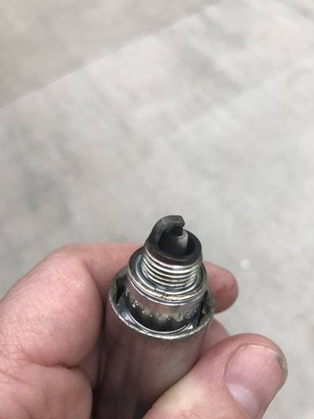

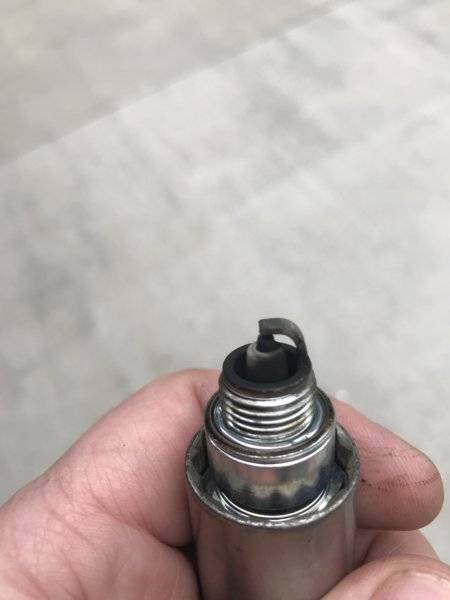

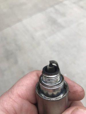

Pulled the #3 plug. This is what it looked like after about 10 miles of driving right after I put them in and dropped the jets.
I’ll work on checking the cranking pressure.
I’ve lowered the timing to 14/30. I’ll see what happens when I can take it out if it ever stops raining!

Plug looks OK. Timing mark is at the curve of the ground strap, but since it is pinging you could pull timing back a bit.
Doesn't look wet from oil so that is good.
Looks a bit rich, likely from idle mixture, unless you pulled it after a hard drive.
