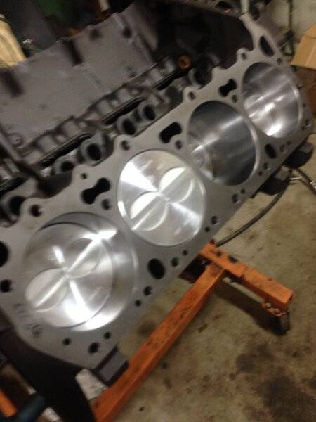

KB 237 is close to a zero deck and will get you there with the Stealth heads. As long as you aren't boosted the hypereutetic pistons are nice. I'm running the same pistons and heads and am around a 10.2:1 with Felpro gaskets.
I’d run some ICON flat top pistons. Forged pistons plus the thinner 1/16 rings to free up some power.
I'm running & recommend Icon's too... However they are considerably lighter which while it is a good thing but because of that they will require a balance job...
