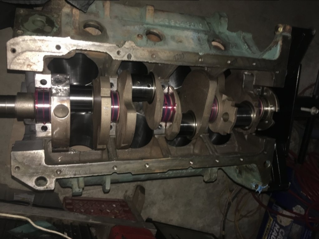

I have pulled down the engine that came with my project to see what I have. I have never had it running because the car was in a basket when I purchased it. Previous owner said it was fresh rebuild but could give me no specifics. Here's what I have found. '74' HP block with forged crank and six pack rods and damper. Pistons are stock standard bore looks like they just honed the block and installed new rings. I can feel a small ridge at the top but haven't measured it yet. The pistons are down in the hole .160" ! Has fresh 906 heads and a new unknown cam with about .430 lift and an unknown duration and no markings I am familiar with. I would guess maybe an elgin or some other generic big block cam. It's barely broke in and the lifters don't look quite right so I will be tossing it. Has a factory six pack setup on it, mallory electronic distributor with no vacuum advance and a melling high volume oil pump.

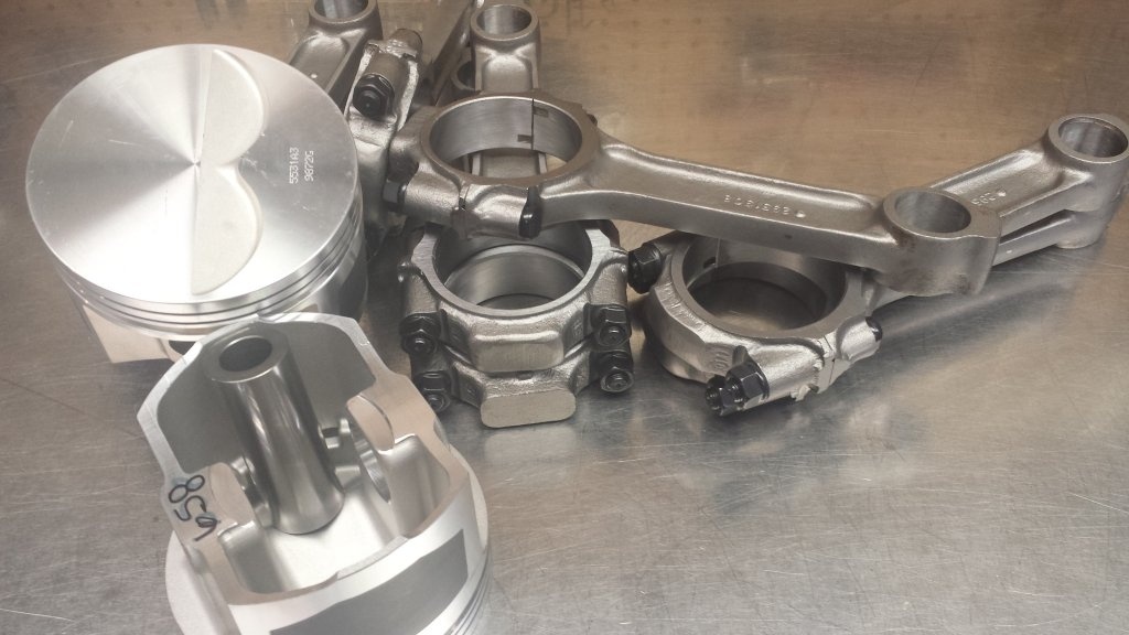

I'm working on a 440 right now for my brothers wagon project . Started off with a motor home donor block that had the 6 pack rods in it.I've had a couple of these engines come into my shop and it didn't matter that they were early 70s they always had the 6 pack rods with the older steel crank and balancer. I'm using the Wiseco street pro flat tops and the steel crank internal balanced with a minimum drill out. The rod weights were all over the place so I weight matched them within a couple grams of each other . Polished the beams and then shot peened them . That process took around 20 grams off of them which helped on the balance. If you need to know a Bob weight I could get that for you.

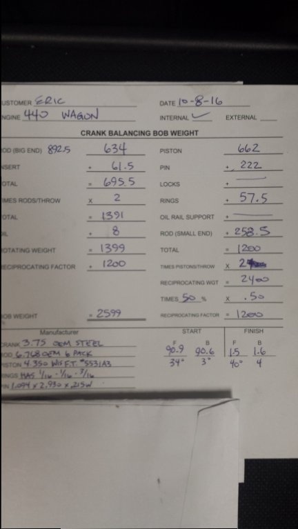

Let me look up the balance card tomorrow and I will get back with you.

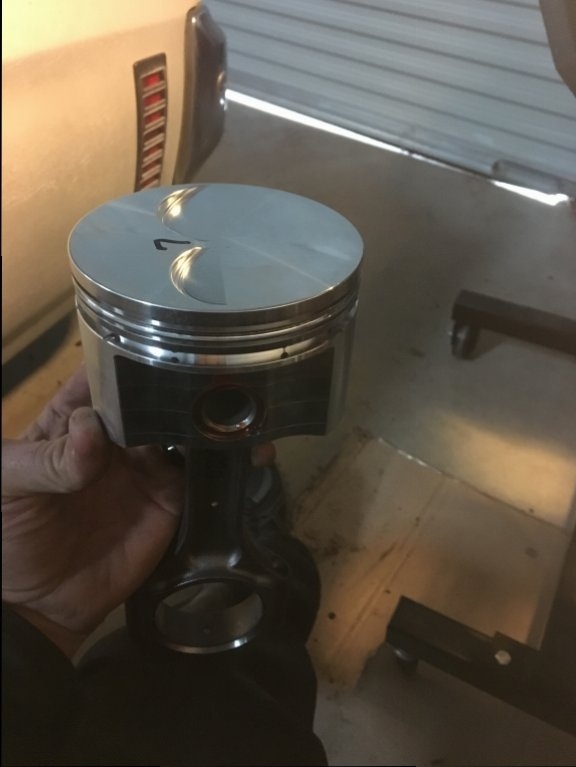

I bought the 440 source Icons that have a smaller ring pack. i called Trend performance and upgraded the wrist pins to H13 tool steel. i thought the Icon pins looked a little cheap. that brought the pin and piston balance weight to 899 grams. I also used older 440 source I beam rods and i needed no Mallory metal at all.

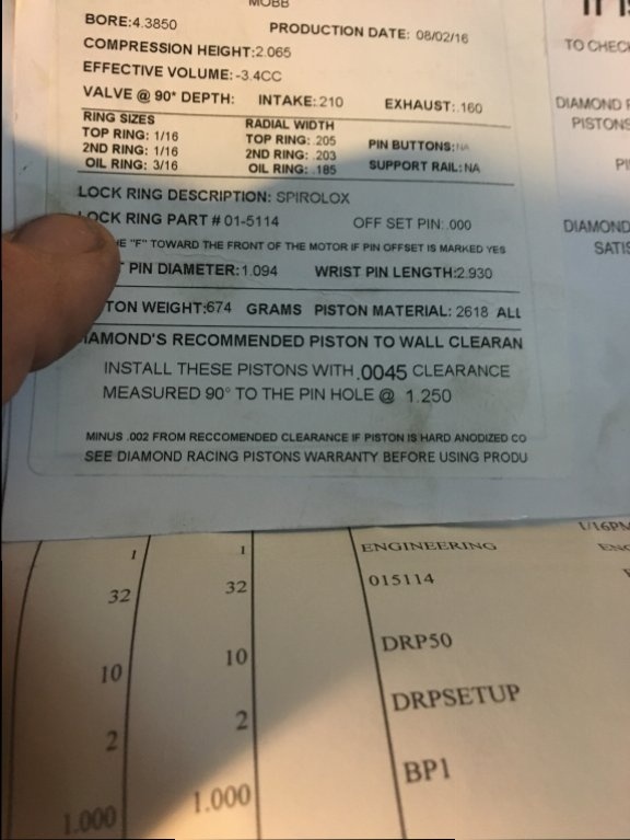

I used eagle rods with 1.094 pin and an off the shelf diamond piston then had it balanced to my six barrel dampener so it will look original and used a b and m flexplate.

Here's the balance card for the combination in question. As you can see on the bottom right of the card, using the lighter piston and the older standard steel crank balancer, makes the balancing an easy drill out or lathe job. It appears that even if you didn't take some weight off of the 6 pack rods, it still wouldn't require the external balancer. These heavy rods would not be my first choice on a new build but, that's what rods were in the engine when we took it apart.For an engine that might see low 6,000 rpm's once in a while I feel the ARP bolts will make this combo strong enough. I'm sure everyone has an opinion on what rod you should use but, I thought you would like info on what you have. Remember I didn't use an external weighted balancer on this. Good Luck
