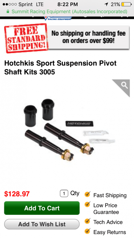

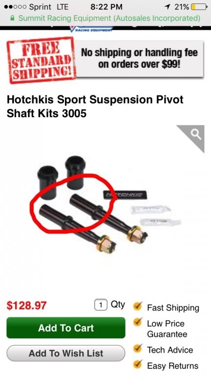

hey guys, does anyone know where I can buy new pivot shafts that come WITH the new metal bushing sleeve?? Everywhere I seen it says to reuse the old one, unfortunately I destroyed one during disassembly. Seen the hotchkis on summit but I don't see the sleeve pictured

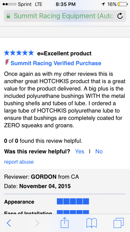

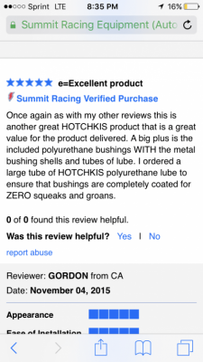

Just seen in one of the summit reviews of the hotchkis shafts he says they do come with the metal bushing sleeve... thinknill just order these and see...

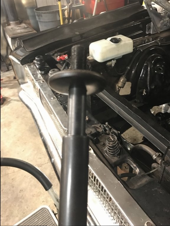

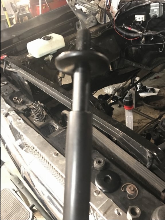

Unfortunately I didn't snap a pic, but I'll see if this helps... there's a metal sleeve that slips around the back of the shaft, see pic attached. First time doing this so I may be doing something wrong but I destroyed that piece and it specifically says in the instructions to re use it
I think I get what your talking about. Thought they came as I described with inner sleeve. Maybe PST can some other supplier has the complete bushing?

No the item in the front end kit from pst is just the bushings themselves no sleeve with that one. I ordered the hotchkis pivot shafts from summit, looks like they come with the sleeve got my fingers crossed.
