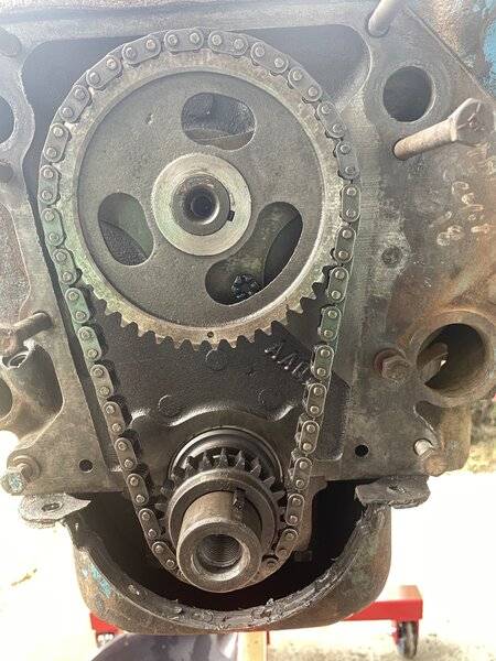

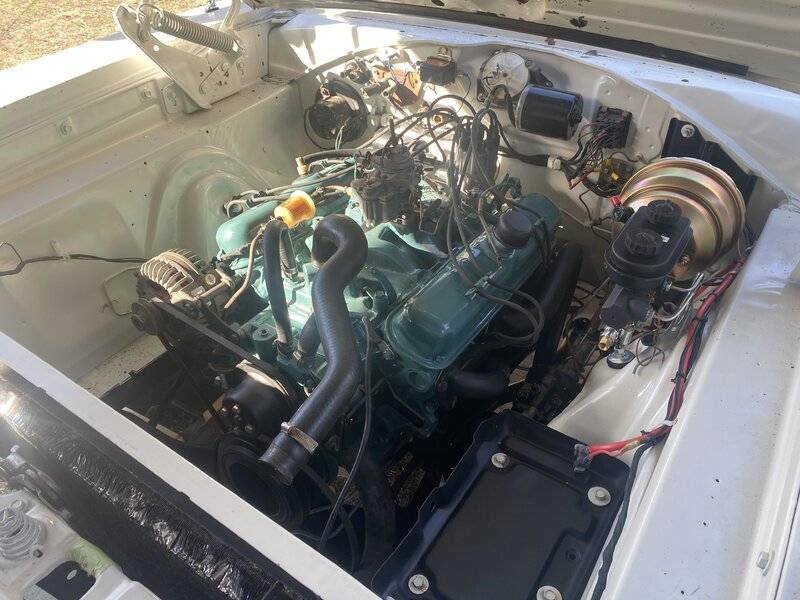

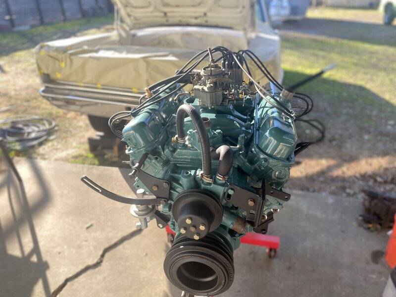

Well, I finally got the engine back in the car after refreshing with all new gaskets and painting it. I also installed a double roller timing chain. I was anxious to get it started to hear the new hooker headers. This entire day was spent on getting it running, no luck. In the beginning I had no spark and the pump was not pushing any fuel. After checking all wiring and adjusting the points I saw sparks at points and wires. The fuel pump was installed incorrectly and after adjusting it, pumped fuel to the filter and carb. I drained a battery trying to get it running now that I had fuel and spark. I made sure to be at top dead center while having the rotor pointing to the #1 cylinder. After rotating the distributor a bit, the best I got was loud explosion noises coming from the carburetor. Leads me to think that the timing is off but cannot figure out a systematic way to get it correct again. The car ran fine before removing the engine. Any suggestions are highly appreciated.

I hope the timing chain is installed correctly.

The oil pump drive shaft was not removed? Or if so synced properly?

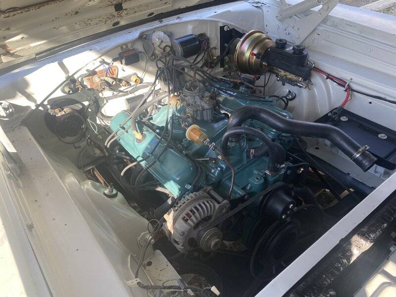

Thanks to each and everyone one of you that provided feedback, you have helped me immensely. I pulled the plugs, rotated the engine 180 degrees, reinserted the distributor and BAM!!! The engine fired up after just pumping the carburetor twice. Sounds loud because of the open headers but it is music to my ears. Last night I could not sleep just thinking about the many things I could have done wrong, starting with the timing chain. Any suggestions on an exhaust system? I was thinking of going with a flow master super 40 series dual exhaust mufflers.
:cursin:
This. I can't tell from the pic provided, but you DID make sure the dots on the timing gears were
exactly lined up with one another, eh?
