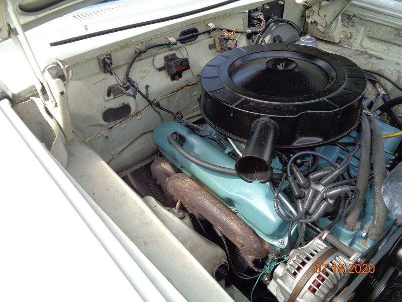

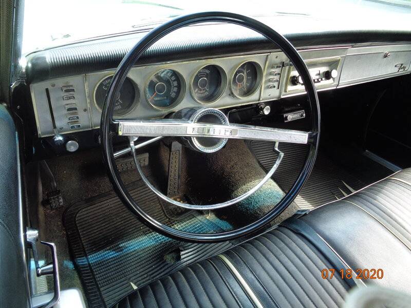

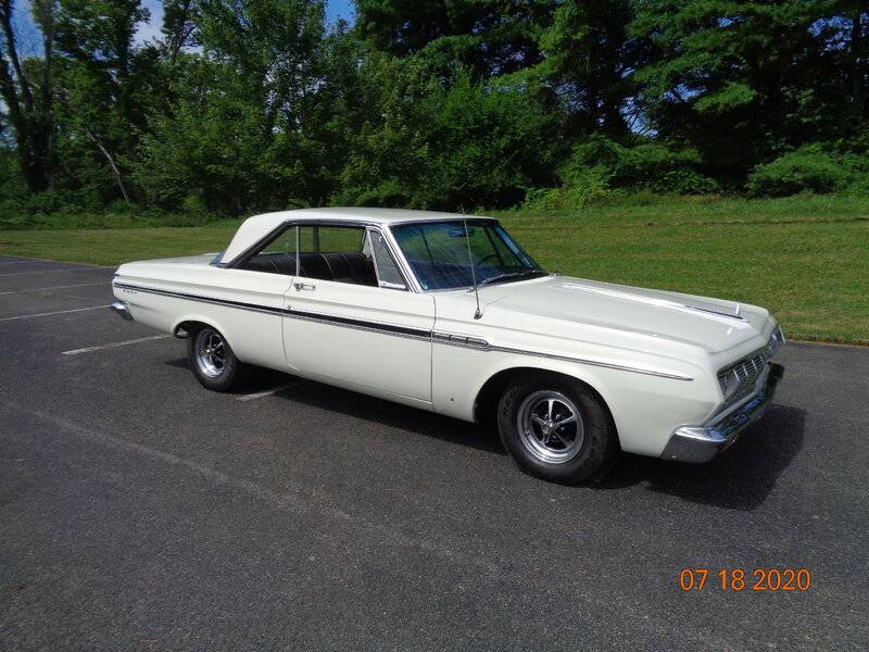

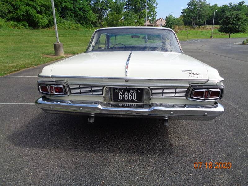

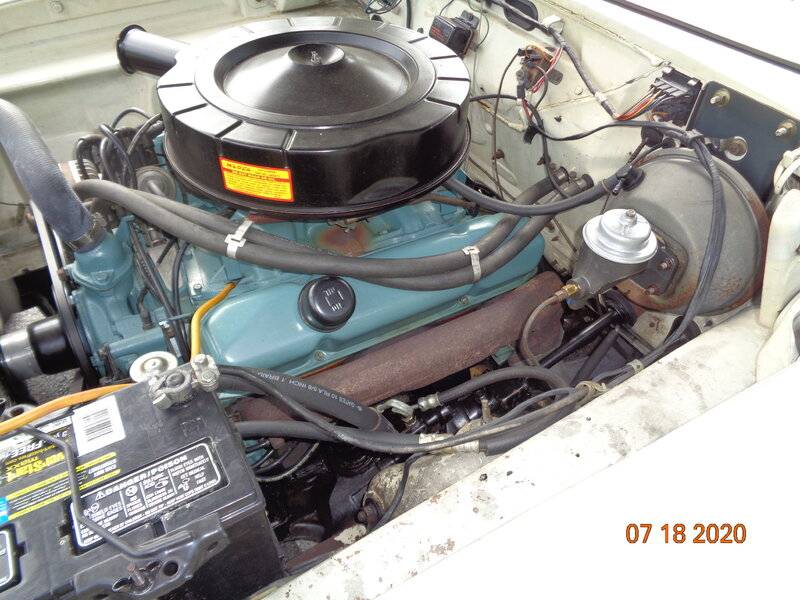

My un-restored, and pretty much original, 64 Fury is a 361-pushbutton car. Has 96K miles now. A few years ago, I pulled the engine and trans to clean it up, stop a few leaks, and detail a bit. My desire was to upgrade a bit, but keep it looking so factory correct that only hard core Mopar guys would see the changes. I switched to a 4 bbl intake and AFB carb from a 65 Chrysler 383. I had a set of the big block HP exhaust manifolds, so used them and ordered a 2-1/2" exhaust kit from TTI. It's no show car, and with the 2:76 gears, would not run with a 383 "muscle car", but it does OK to drive and enjoy...

And YES, replacing that yellow battery ground cable is on my list of stuff to do.....LOL

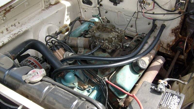

The 361 hp, 4bll, dual exhaust was standard equipment in a 1962 Polara 500.
The 361 as it came in my '62 Polara 500.
Replaced it with a '67 440 and placed the 361 under the work bench for future restoration if the need arises.
