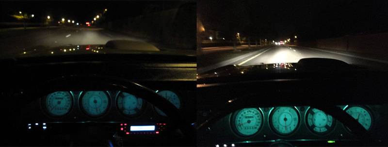

There is a substantial increase in voltage at the headlight, increasing light output performance. Light output degrades exponentially with voltage input reductions. These kits also take headlight amp loads off the fragile bulkhead connector, headlight switch and amp gauge. The only headlight load flowing through the bulkhead is a minimal current required to trigger relays.

Picture of the light output difference from a 71 Cuda. Both pictures are on low beam setting, Left - before, Right - after installation.
Another benefit that most users see are an improvement in dash light and marker light/turn signal brightness.

Does the relay make the instruments brighter too, as in your pictures?

Yes the instruments and all the other lights generally get brighter because the headlight load is removed from the OEM harness.
