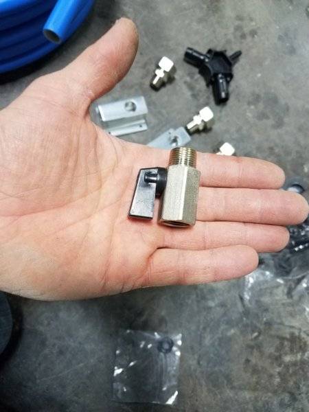

Here's my biggest disappointment that I'll fix, I love the wall mounts for your outlets but they have a 3/8" NPT on one end for a drain so no option to pass through with the 3/4" piping when running a series of outlets at the work bench. I'll drill and tap them so it's a simple in and out saving $18 per T.

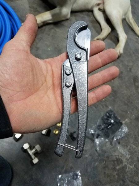

It is stiff. But, you can unroll it fairly straight by manipulating it a few feet at a time. It helps to plan out where your clamps that hold it to the wall will be placed so you can clamp it down as you go and that gives you leverage to get the next few feet. Be sure to make clean bevels with that cutter.

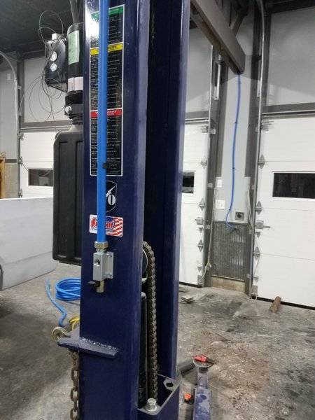

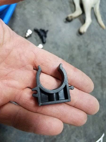

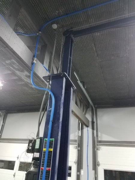

This will be a short thread, this is stuff goes up fast! After some members told me you can easily straighten this stuff without the rolls I tried it, no problem. I rolled it out on the floor then chalk lined and mounted the clips every 32", once installed you just tweak anything that's off and move on... easy peezy.
Here's where I dropped through from upstairs then supplied one side of the lift and will also branch off to supply the addition. One benefit I really love is the ability to bend nice offsets in the piping when you want to hit studs.

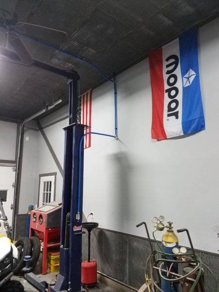

Then across the ceiling to the other side of the lift. I wanted the line ran across the ceiling so it came out perfectly in line with the other post but no joist and a metal ceiling... then I remembered these
:thumbsup:. The other T will be to route an air drop in between the garage doors.

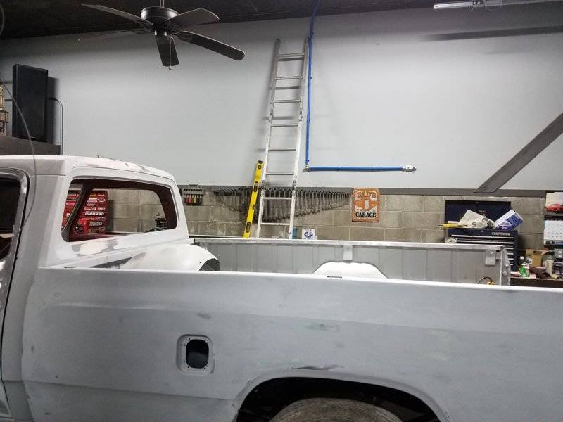

Across the other bay then the drop for a few outlets at the workbench then over to the lathe, that's where I stopped. I chose to mount these high so I have room for a pegboard and will put pigtail hoses on them .
