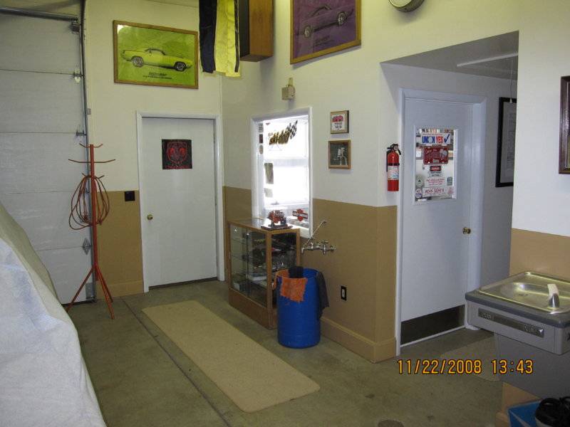

I furred out my pole barn walls on 24" centers by running a 2x6 (PT) along the floor fastened to the poles and then fastening the 2x4 furring strips to the inside 2x10 joist carrier at the top and the 2x6 at the floor (floating the inner wall-not touching the outer purlins). Then insulation can be stapled on to the furring strips. After that I stood drywall (5/8) on the 2x6 and up to the joist carrier, trimming the top and bottom edges with 3/4" 1/4 round and painted everything.
On the outside I dug out a 4" deep by the width of the eave hole and filled it with stone (septic tank/drain field size). That keeps the dirt away from the steel skin and the eave dripping from cutting a line in the lawn. Makes mowing easier too!
On the outside I dug out a 4" deep by the width of the eave hole and filled it with stone (septic tank/drain field size). That keeps the dirt away from the steel skin and the eave dripping from cutting a line in the lawn. Makes mowing easier too!View attachment 651840

That's what I was getting at, it can be done but with a pole barn you have to add furring strips, studs, etc if you want to finish it whereas with a stick frame you just stuff the 16 centered studs and hang drywall... done. Nice looking garage BTW:thumbsup:

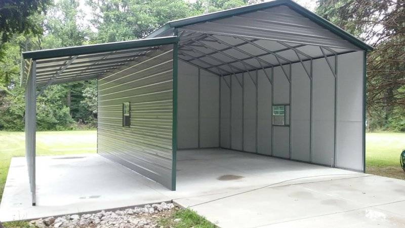

There are other considerations and at least another choice as well. Pole barns are considered as not having a foundation, so property tax rates are lower. Another choice is a “carport” building. It’s a steel frame usually built on a slab on grade. Since it technically doesn’t have a foundation either, the property tax benefit applies to it as well. A stick built structure must have a foundation that goes below the frost line (more expensive than a slab on grade). Plus it is a real structure, so you will be paying full property tax on it (check your local municipality’s ordinances on this question before you make any choices).
I went with the carport option here in high property tax NJ. I had them install sheet insulation on all closed sides to keep the sun from heating it up in the summer. It is 20x30 feet with 12 foot tall walls and a 9x30 foot shed roof on one side. So essentially it is 29x30 feet. I roughed in electric, water and sewer pipes into the slab for potential future installation. The slab cost $9,500 and the structure was $10K installed. It went up in a day and a half. No increase in property taxes either. Future plans call for adding a front door to it too. I wanted it to be standing for a while beforehand in case the township came over to inspect it (that way they would see it is not a garage but a carport instead).
