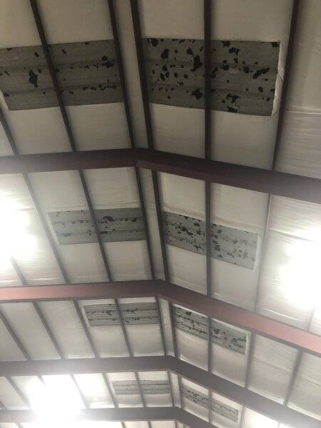

Regrets:
Don't get skylights. After 6 years, a hail storm finally finished mine off and I put R panel in their place. But before that, crows would peck holes in them, they would drip condensation, and they get dirty and yellow quickly.
